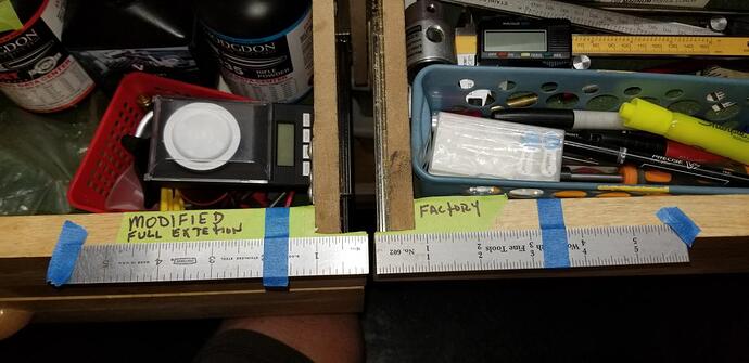

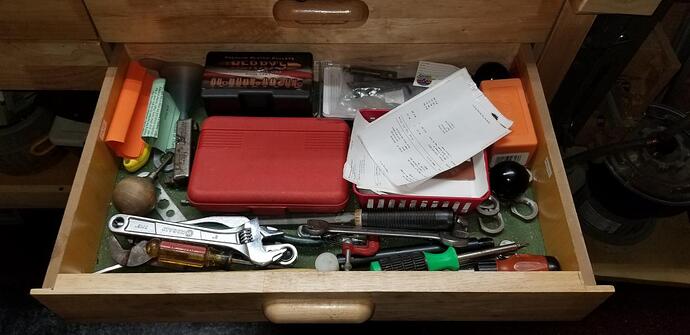

Andy ;i bought new full extention slides from lowes, but you need to cut the drawer width Not that hard with a table saw.i also converted the left two drawers into one deep drawer by removing the bottom of the top drawer and joining them with rafter plates
I need to correct my self, Its not 5/8" Cannot get other photos loaded. If you like I can send them by email. Center photo is with new full extension slides, other is factory slides fully open
far right is the change you need to make for new slides

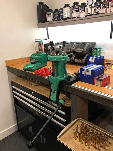

The page I modeled mine after is gone, unfortunately. I recently moved so it isn’t currently set up but I can describe it fairly well: I purchased 2x 4’x8’ sheet of 3/4" oak plywood, cut them in half lengthwise and glued and screwed them together from the bottom side. I then had 3x 1.5" galvanized rigid pipe (determines your bench height) threaded to fit into commensurately sized floor flanges, the flanges attach to the underside on each end and in the middle of the bench with wood screws, the other end can be screwed into the floor if desired. I then lag screwed a 2x4 on-end to the wall side of the bench to be used as a cleat to bolt into the wall. I sized mine so I can stand but also sit on a stool if desired
It is hell for stout, I weigh 190 and I can sit or stand on it no problem. There is probably no need for the added expense of two pieces of oak plywood, the middle layers are wasted and common plywood can be substituted. I like the smooth veneer on the top and I finished it with multiple coats of polyurethane. I’ll see if I can set it up temporarily and get a pic in the next few days.
I needed to do some work so I set it up temporarily

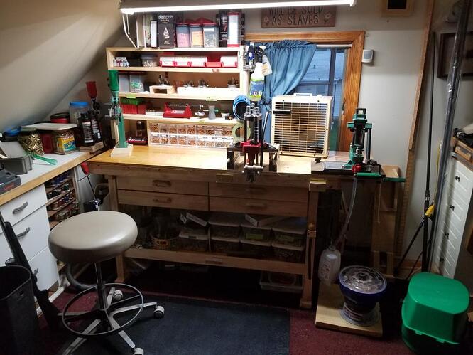

I ended up using some old fir 2 1/2" thick planks which I planed and laminated together. This bench is pretty solid.
