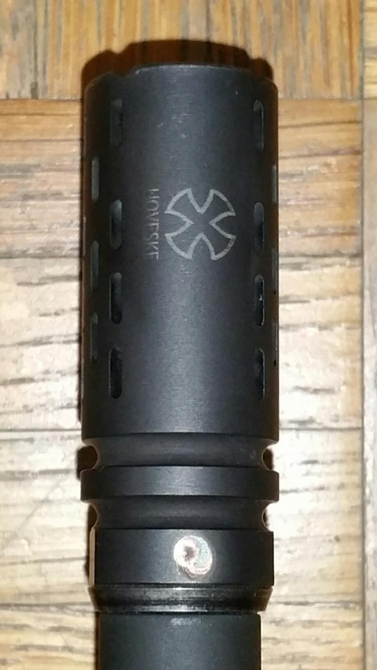

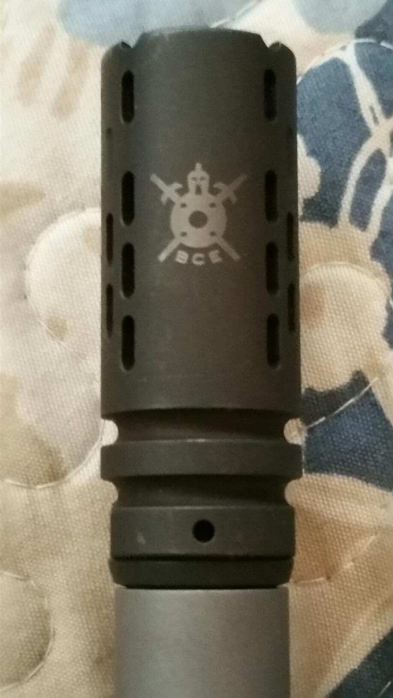

Anywho, here are two pics. One is of a barrel I just recently had pinned with a Battlecomp(took the pic before they pinned it), showing the pic for reference of the pre-drilled hole. The second pic is of the barrel I would like to have the pin removed and what it looks like.
