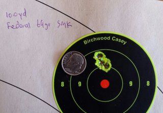

“I need choosing a inexpensive/long lasting/ accurate barrel”
You have described a Faxon Nitride barrel. You will be shocked by the quality for the price.
I bought one and as soon as I tried it ordered another.
This was reported by a user:
16" 4150 SOCOM profile barrel with Federal Gold Match 69gr SMK.
