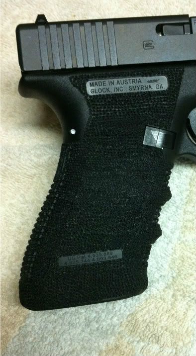

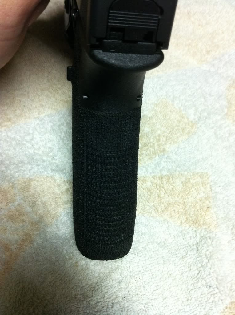

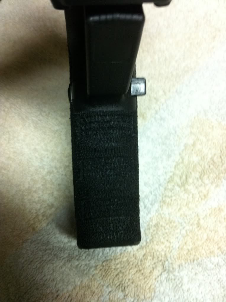

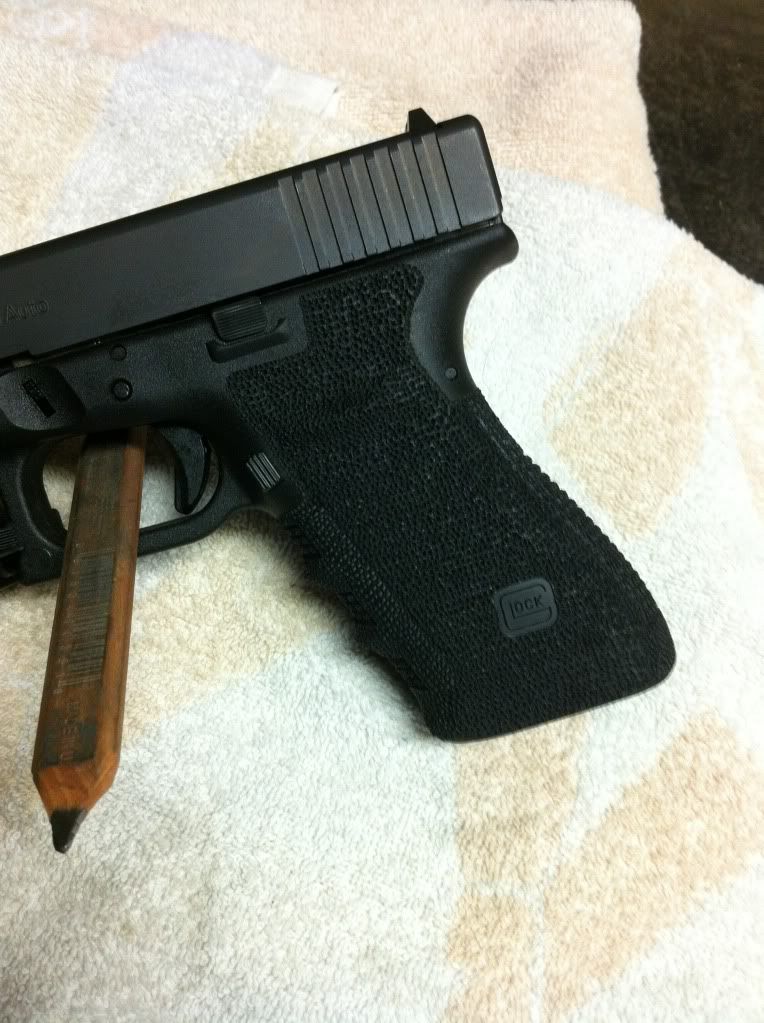

Hey im new here! I just got done stippling the grip on my Glock 21 last night. Let me know what you guys think. Sorry if the pics suck. They’re from my cell phone.

I used a soldering iron with a pointed tip. It took me 2 1/2 hours all together.

I would just like to impart some knowledge I learned from my first experience with this technique. It may seem less restraining by buying a battery powered soldering iron but it will take 2 sets of batteries to do one blaster. This may seem like common sense but I made the mistake and wanted to pass that on.
I am getting ready to do my G-19 and these pics definately give me an idea of what I am in for. Nice looking, did you use any kind of masking or just a steady hand??
I just came up with the outline and used a steady hand. The outline is the hardest part making sure its straight.
I forgot to add. I used a pencil to outline.

Not too bad it might help cosmeticly if you take the original grip texture off first, but other than that looks good…

I wasn’t sure how to take off the original texture and didn’t want to screw it up.
Could someone who knows how to remove the original texture/finish please explain the process or post a link to a how to?
Thanks in advance.
Also, cbrkurt, nice job. :slight_smile:
I second that. If anyone knows how to do it please spill the beans.
I used a sanding stone dremel head to file down the orginal checkering and finger grooves on my Glock. I then stippled the grips with a soldering iron.
Sanding block (sponge) to remove original texture. I know people love their dremels, but it’s too easy to mess up using power tools.
