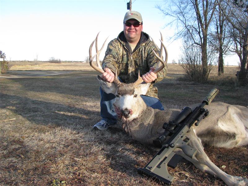

This is the best pic I have of the rifle, so please excuse the “redneck-ness” of it. I had just killed my largest buck, so I was grinning like a cheshire cat.
First option is send it to leupold custom shop and have the rectical swaped out for a diffrent one. Check out there website. Next option switch to the scope I’m running Horus HAWK here is what it looks like on my hunting rig. I can engage from point black to 1000M effectivly glass is super awsome cost is low for quality.

Looking at the rifle in your picture you have a solid 400 yard rig max. If I were going to put some type of scope on it I would go with a Leupold VX3 on 3.5x10x40/50mm. I like the 50mm objective myself since it brings in a bit more light at dusk and dawn. It is a solid hunting scope and won’t break the bank. Like you said Tac-ing out your rifle isn’t what you want.
