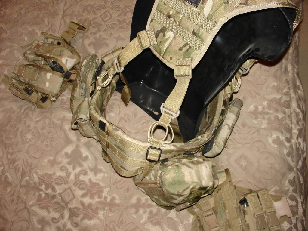

You can see the whole setup here and how it went together.
You can see the front suspenders, I cut them at about the center point but ended up not even needing any of the front portion of the suspenders - what you see is the straps that came mounted to the x-harness joined to the old suspender attachment (550/elastic) points.
The back did utilize part of the old suspenders but it didn’t take much. Notice that due to the 550/elastic attachment points that the nylon can cant inwards to match the angle of the x-harness attachment points. It works great and feels like I am hauling half the weight compared to the old HSGI suspenders.
Glad I did it - hope this helps some of you guys.
That worked a lot better than I expected it to. I am so used to wearing the back-half of my HSGI suspenders toward my midline that I thought the angle would be all wrong.

I actually like where my gear is positioned now, so I will leave it as is -
but if I was to move the rear suspender attachment points further around towards my sides (say at my 8 & 4 ) it would probably further enhanced the weight dispersion.
