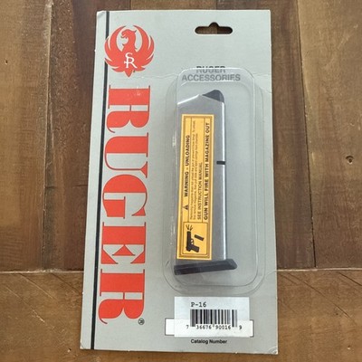

Ebay has several factory mags in the $50-$70 range such as

Oo..i like this idea! Thanks!
I saw and lost a bid on one. This is probably just going to be a fun and / or stash gun. I don’t need many mags for it, especially at $50+ each. But 2-4 extras would be nice.
