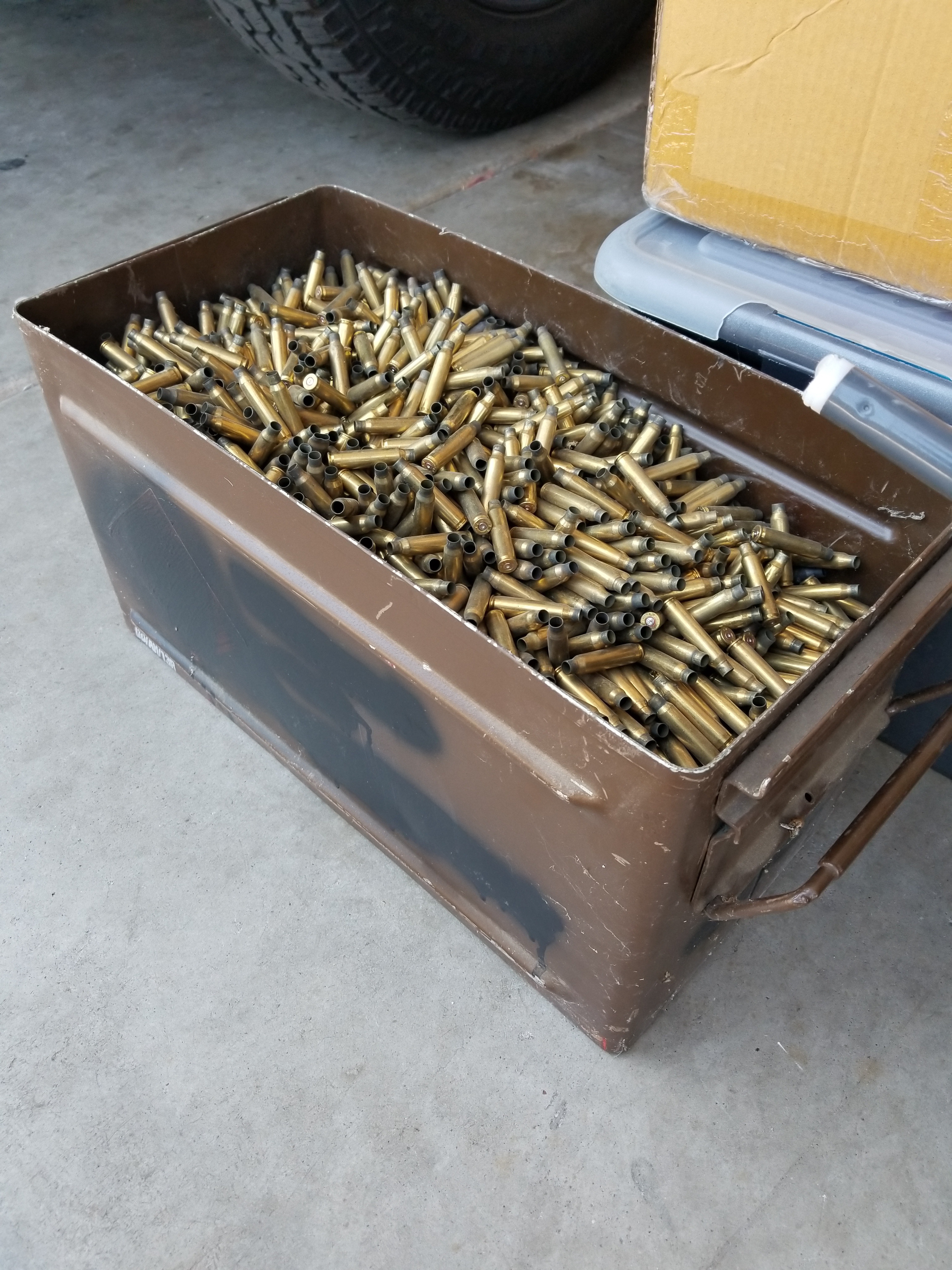

Damn! This dude Pappabear knows/shoots pistol matches with gave us what I estimate to be 4000 pieces of once fire FC brass from some military or LE range. He doesn’t reload 5.56 so we got it all.
I’m about to learn the true meaning of bulk brass prep since it’s all crimped primers too.
That’s a good score!
I like FC brass and have shot some great groups with it in 223. The downside is that it is on the softer side. If you load it anywhere near max pressures, you may only get one or two more firings before the primer pockets loosen up.
Yeah. I’d have been thrilled if it were all LC. But FC is worth the effort. I got a hundred ready to hand prime. I want to complete a test batch before starting a marathon decap run.
