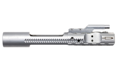

How did we not talk about this one? Centurion Arms Sand Cutter Carrier
C4 Bolt Carrier, Hard Chromed, with Sand Rail Cuts
Fully hard-chrome finished, the V1 8620 steel, full-auto weight carrier includes a proper machined Mil-Spec gas key that is chrome lined, phosphated and heat treated per the TDP and is secured to the carrier via Grade 8 fasteners and properly staked during final inspection.
Sand cuts are added for increased reliability in harsh conditions.
Obviously, “sand cuts” aren’t a new concept, we can look back to the FALs which were probably the first common firearm which used cuts to abrade, loosen, eject junk in the action. While a lot of people tend to focus on the “SAND” aspect, this style of carrier also works for weapons using cans or weapons which aren’t cleaned on a regular basis. For anyone who hasn’t used a can, not only does it get hot, it also kicks a lot of crap into the action. Cans are also heavy, make your gun longer, but they do lessen noise to a degree, and they do look sexy.
I think the hard chrome is a nice touch as well. While hard chrome might not hold lube the way parkerizing does, it does increase lubricity. Cleaning is also a nice secondary feature of hard chrome, but anyone who thinks their carrier will remain perfect and have a nice sheen is going to be sad. They do darken up eventually.
The carrier being made from good steel and having the correct staking and specs is something I would expect from Centurion Arms, so no shock there.
Thoughts, opinions and comments?
