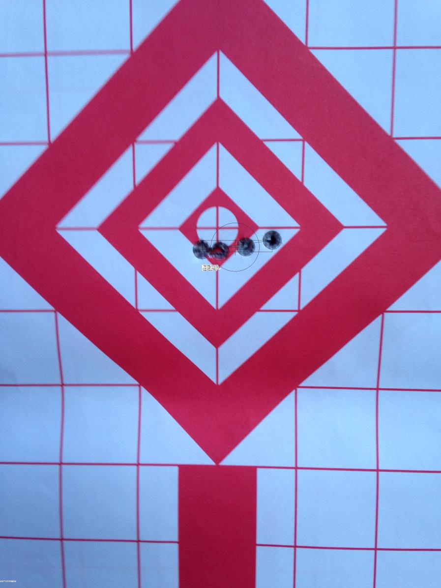

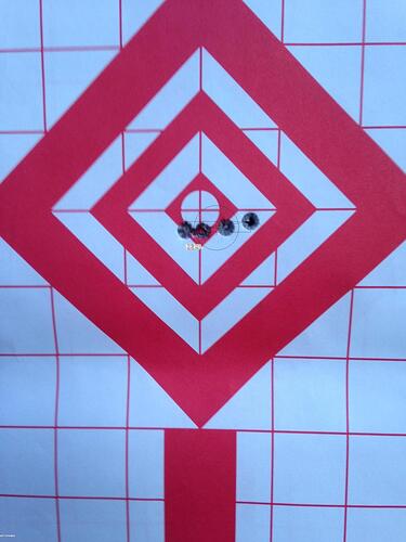

At 100 yards, the rifle and this load will repeatedly shoot under .25 minutes, and if I am doing my part, under 0.2 minutes.

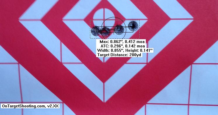

As I move further out, the vertical dispersion of my group stays nearly the same, right around 0.2 - 0.25 minutes. The horizontal dispersion, however, keeps growing, at 200 yards it is roughly 0.5 minutes and at 300 yards the horizontal dispersion is approaching 1 minute, while the vertical dispersion is still staying around 0.2 - 0.25.
Am i correct in thinking that this is a neck tension issue? I want to keep pushing the distance but I want to solve the problem with the horizontal dispersion before I do. Any insight at all will be greatly appreciated.
We get that from time to time as well. It’s shooter induced… although I don’t know exactly what causes it most of the time.
Are you getting a good straight back trigger break?
Thanks for the reply markm, was hoping to hear from you. Yes, I believe that I am, and I usually am good at calling my shots and fliers. If this is shooter induced, in regards to trigger manipulation, have you found a way to overcome the problem?
I do a lot of dry fire with my Glocks for ipsc, but not as much with any of my ARs/Geissele triggers. Also, in my 300 win mag, out to 600 (cant go much further around here) I do not see horizonal shifts like this unless I am completely neglecting to take into account the wind.
Do you wrap your thumb around the backside of the grip? If so, I bet you are pulling the rifle when squeezing the trigger. Try keeping your thumb on the same side of the grip as your fingers and see what kind of results you get.

Not really. Is this happening a lot/consistently? Do you have a nice, fast trigger, etc? I try not to over-react to occasional grouping issues.
There’ll be days were it’s a friggin fist fight to hold MOA. It just happens. There’s guys that’d be thrilled to shoot the group you posted… but with that vertical is so nice that it does beg to get the horizontal improved too.
If reloading is your issue, horizontal dispersion is, as a general rule of thumb, caused by seating depth, as vertical is powder charge. Providing you have proper case prep, and are not overcrimping, or some other improper technique. Dan.
Vertical dispersion is generally a result of variations in pressure and velocity.
Horizontal is a result of wind.
Remove the human element (i.e., shoot from a secured machine rest) and you’ll see rifle-ammo group trends.
In team rifle shooting (4 shooters) it is the responsibility of the shooters to hold for the tightest group they can. If rifles and ammo are consistent then all shooters should be able to hold a half to a minute of angle group height. The shooter is responsible for elevation.
It is on the coach and his wind reading abilities to keep the shooters’ groups centered within a half to a minute of wind, keeping everyone synchronized and inside the 10 and X-ring.
Most folks will never experience this because they are shooting, loading, and proofing on their own and scratching their heads trying to figure out what is voodoo vice science.

Markm, this does happen consistently with this load, but not with any other rifles. Trigger is a Geissele SD-E.
SingerDan, That would normally be my first thought as well, as I have found that to be the case many times loading for bolt guns. For this rifle I am loading for mag length, well out of the lands, which is what ultimately has me thinking it could be a neck tension issue.
Sinister, when this first started happening (any time I took the rifle past 100) I too thought it must be the wind. Nearly all of my shooting past 100 up to this point was done with heavy, long 6.5mm and .30 cal pills. So I initially took it as an opportunity to improve my ability to read the wind, quickly becoming frustrated as a result of making what seemed like no progress.
I have made a point of shooting in as close to zero wind conditions as possible, shooting the “let up”. Ultimately, the horizontal dispersion remains.

Everything folks have said above is dead nuts on. My knee jerk was trigger (operator induced) and wind (mother nature - that b*tch) but as I read more and more - this seems more like an equipment issue.
Couple of things to look at.
  1. Gas tube to key interface - if your gas block has shifted ever so slightly, (rotated or moved forward) the movement will be magnified at the key. This does goofy things to barrel harmonics - inducing horizontal stringing and vertical stringing.
  2. Be very aware of bench technique - AR’s can be finicky off the bench - also - not a fan of bipods on hard surfaces - ditch the bipod and shoot off of bags. Put the bags right in front of the mag well.
  3. Probably the most unlikely, but worth a check if the issues above come up blank - check the scope. I see you are shooting NF - but hey, shit happens. Scopes - even the best can go wrong. Run a simple box test on the scope at 100 yds moving the reticle 2mins for each side - see where you come back to.

It could be trigger control or the effects of wind or it may not be. Have a friend shoot groups with the same loads and see if you get the same results.
It could be the load. I developed target loads for my 8mm and 30-06 rifles and observed horizontal stringing with lighter charge weights. I incrementally increased the charge weights until the groups were concentric. The charge weights vary depending on bullet weight and bearing surface length.

my guess from looking at your target is
if you are right handed, it’s cant
if you are left handed, it’s wind
markm had a good point though. pushing the trigger is a possible culprit, especially when it starts at the center and goes one direction. but the direction could be different with freehand vs bipod vs bags. basically, is the front of the gun fixed and your finger is pushing the backend? or is the backend fixed and your finger is pushing the front end?
Again, thank you all for the input. As of now I am planning to address as many of these points as possible during the holiday weekend. Some family members are IBS (International Benchrest Shooting) competitors and we are planning to get together at their home to try and figure this out once and for all. All shooting will be done from a solid concrete bench, bagged, with wind flags, spotter, etc. at 100, 200, and 300 yards. I plan to work up a number of rounds of this load, with slight variations to try and really pin this down. If you all are interested I will photograph and document our findings as we go.
Cant will manifest itself with windage shots that are low - those groups do not show low or “corner” shots as they are referred. It very well could be a load tuning issue, but I’d make sure you rule out the mechanical issues before you start chasing load issues - that could make for some very frustrating bench time.
at distance, yes. at 200 yards, i wouldn’t expect more than what’s on his targets now
