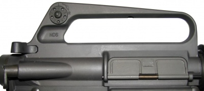

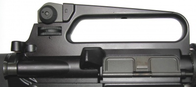

Whats the difference between A2 (seems to be most common) and A3 receiver types?
A1: “carry handle” with built in aperture sights adjustable for windage, by pushing this with a pin while rotating that - quite Mickey Mouse
A2: “carry handle” with built in aperture sights adjustable for windage
A3 & A4: no carry handle, go with BUIS
my drill sergeant got real irritable when he heard “carry handle.”
http://www.imfdb.org/wiki/Colt_AR-15_Identification_Guide
