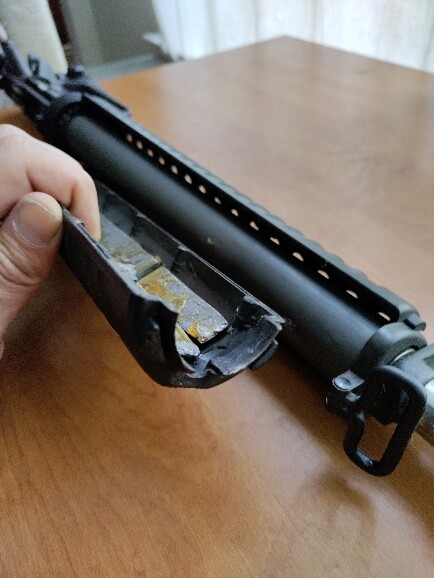

I was going to install the classic triangular hand guards on this gun with a DPMS upper but they will not fit. The hand guard cap is different and I have never seen this type of heat shield. I need help identifying what type of heat shield it is so I can research what I need to do. I thought about just replace the barrel with a 20” pencil barrel that is not stainless steel. The hand guard that is on the gun now is the ribbed ones. Thanks for the help
I don’t think that’s a heat shield. That looks like a national match type float tube for service rifle competition. It retains the traditional external appearance while floating the barrel.
Standard handguards had to have some plastic routed out of the front lip in order to clear the tube, without any sort of traditional heat shield involved.
Here is a pic of the handguard on my old CLE match upper.
…Ignore the stick-on wheel weights, they are only really helpful when firing offhand
