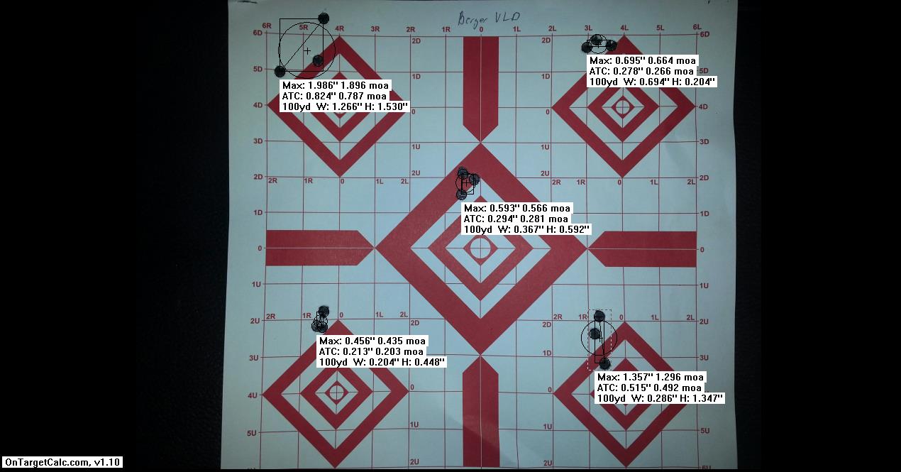

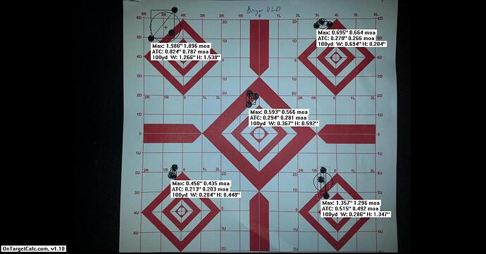

After you find the powder and charge that your rifle likes then you can start playing with COL’s. the target below has five groups with the seating depth changed 0.01 for each group. With bergers it really makes a difference. MK’s more forgiving.

Nice,really shows how much COAL can make a difference. Finding that sweet spot really shows.
