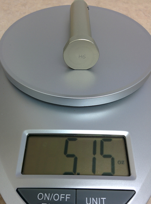

H6 Buffer.
I’ve never seen the correct weight for the H6 CAR buffer posted anywhere, so for reference here is the correct weight: 5.15 oz, the same as a rifle buffer.

Correct me if I am wrong, but it is my understanding this was designed for using a carbine receiver extension on the M16.
Correct. And I have built (3) rifles using the H3 buffer and a spring with a Colt/FN 20" upper and they have all run 100%. The difference between the H6 and a real h3 isn’t great enough to require a special buffer.
I think Damage Industries sells them. I don’t see it working any worse than an H3, but I wouldn’t pay a dime more for one than a quality H3, like from G&R Tactical.
It was a competitor to Vltor’s A5 system for fitment of a carbine-size stock to an M16A3/A4 upper.
So this whole thing’s claim to fame is that it uses 6 small tungsten weights instead of the regular 3?

What’s inside?

From what I understand, that is the only difference between this and an H3.
