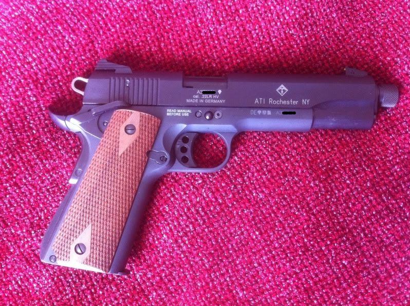

Just prior to Christmas I picked up a GSG 1911, but hadn’t really had a chance to shoot her until last week.
First of all, I’m pretty impressed with the general look and feel of the gun. It feels heavy as it should, but the slide is of course light so 22LR ammunition can cycle it. No blemishes of any kind and after 350 rounds it still looks good with only a couple of use marks.
Dis-assembly is very very easy. Much easier, in my opinion, than a traditional 1911. But there is one key element you can mess up, and I’ll get to that in a moment.

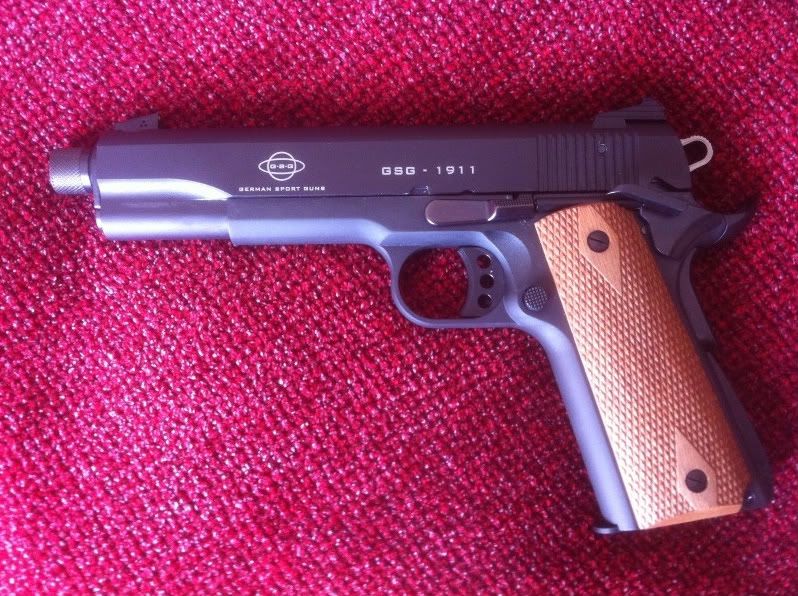

GSG 1911 - 22LR with Threaded barrel adapter:
