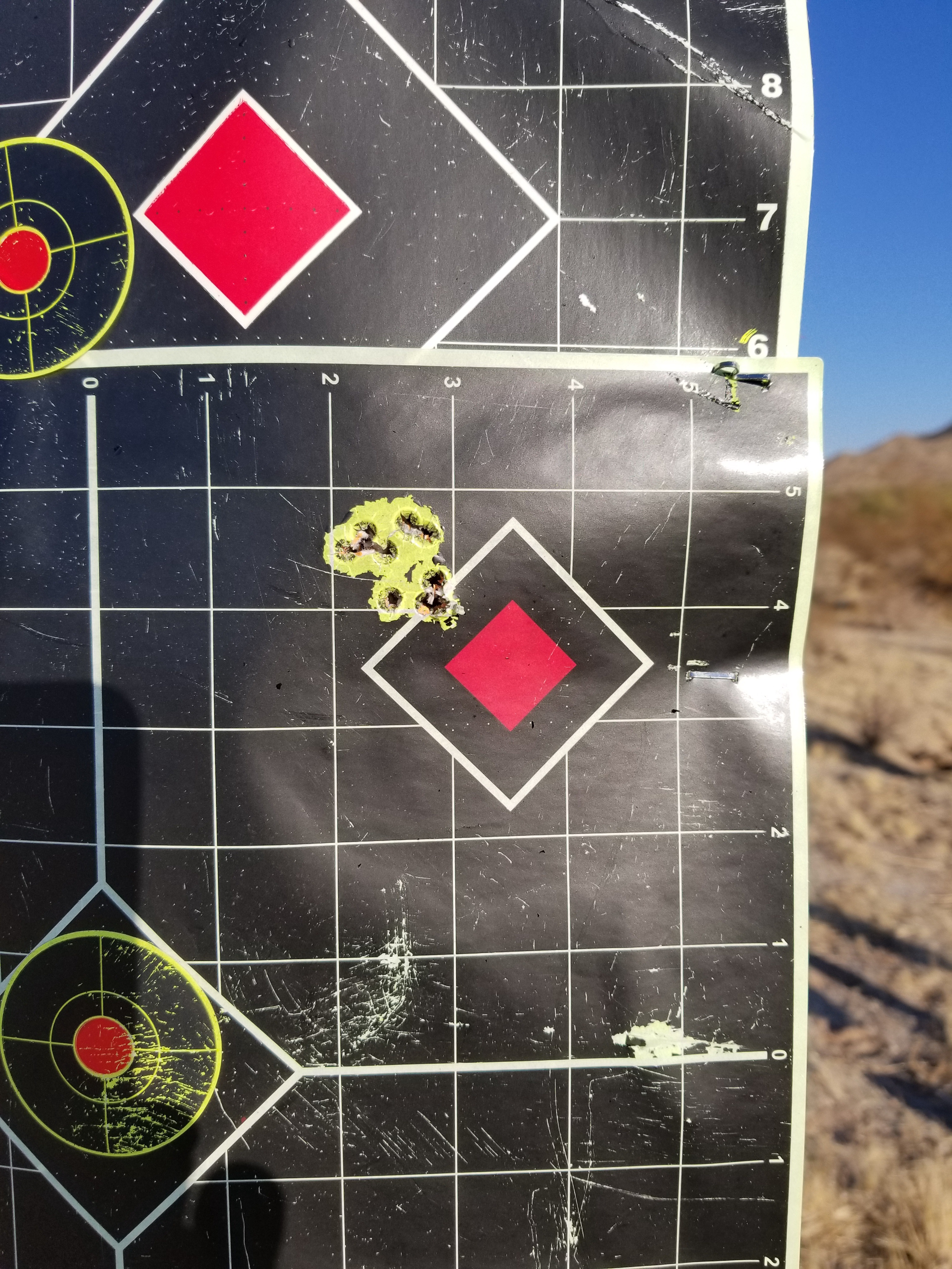

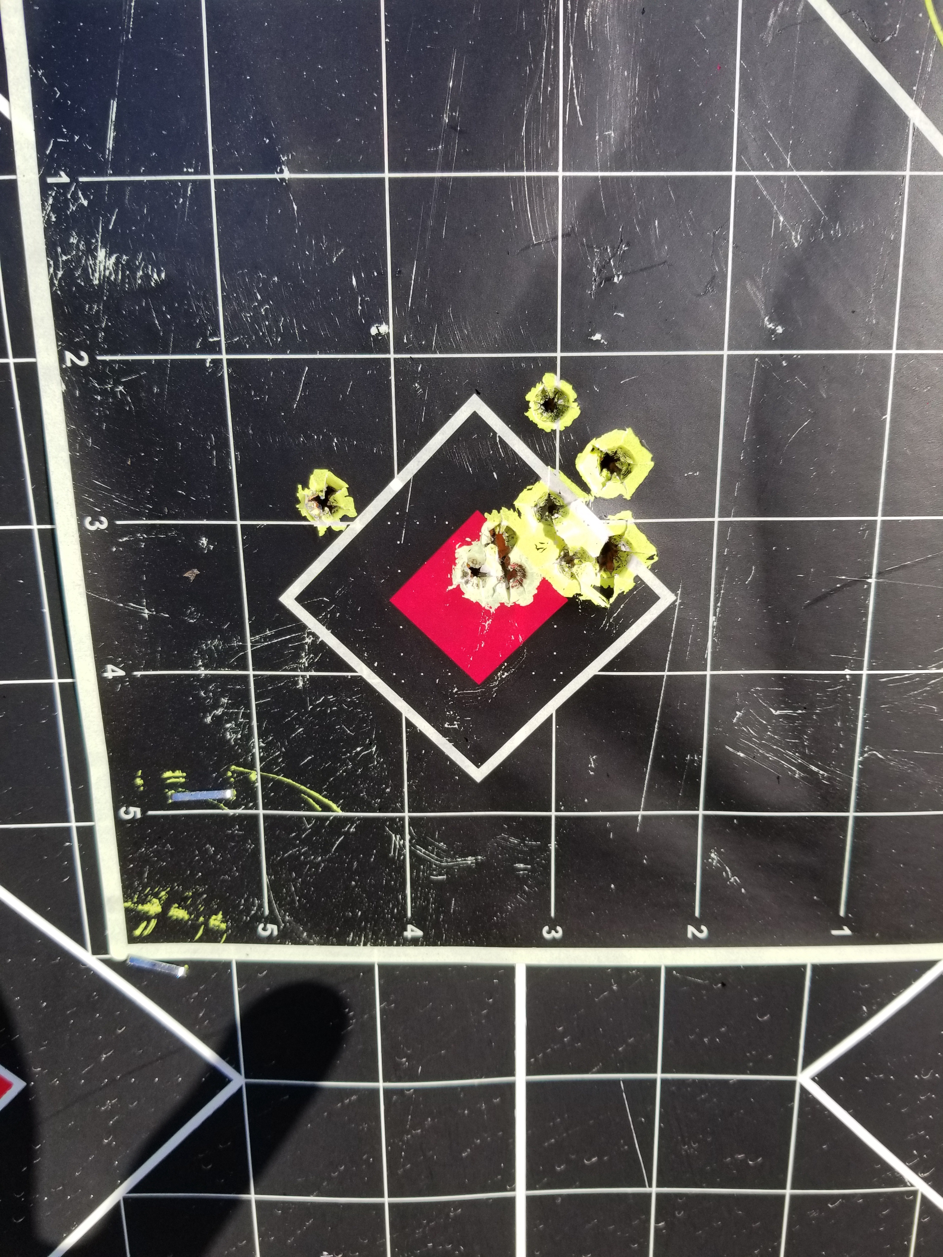

We shot the super challenge today at 100 yards. I went first on a truly clean cold barrel Rem 700 5R with the VMAX load above and watched the barrel settle in, but didn’t get sub MOA.
First round was the flyer out left.
Pappabear cleaned up with the Geissele 16" Super Duty that has an ATACR. Same Ammo, cold but not clean barrel.

That’s damn good shooting though, both of you.
Good shooting indeed. Was the red diamond the target intended? As per the terms of the challenge, all 10 shots must be on target though.

Yep. I was going to shoot 5 rounds to foul the barrel, but I also wanted to watch the progression, so I rolled the dice on the clean bore.
The Geissele barrel is outstanding, but finnicky as hell. When it gets dirty, POI walks down 4 inches and right 2 inches. We re-zeroed it one time, then cleaned the barrel, and the POI was back to it’s original spot. Strangest barrel I’ve ever shot.

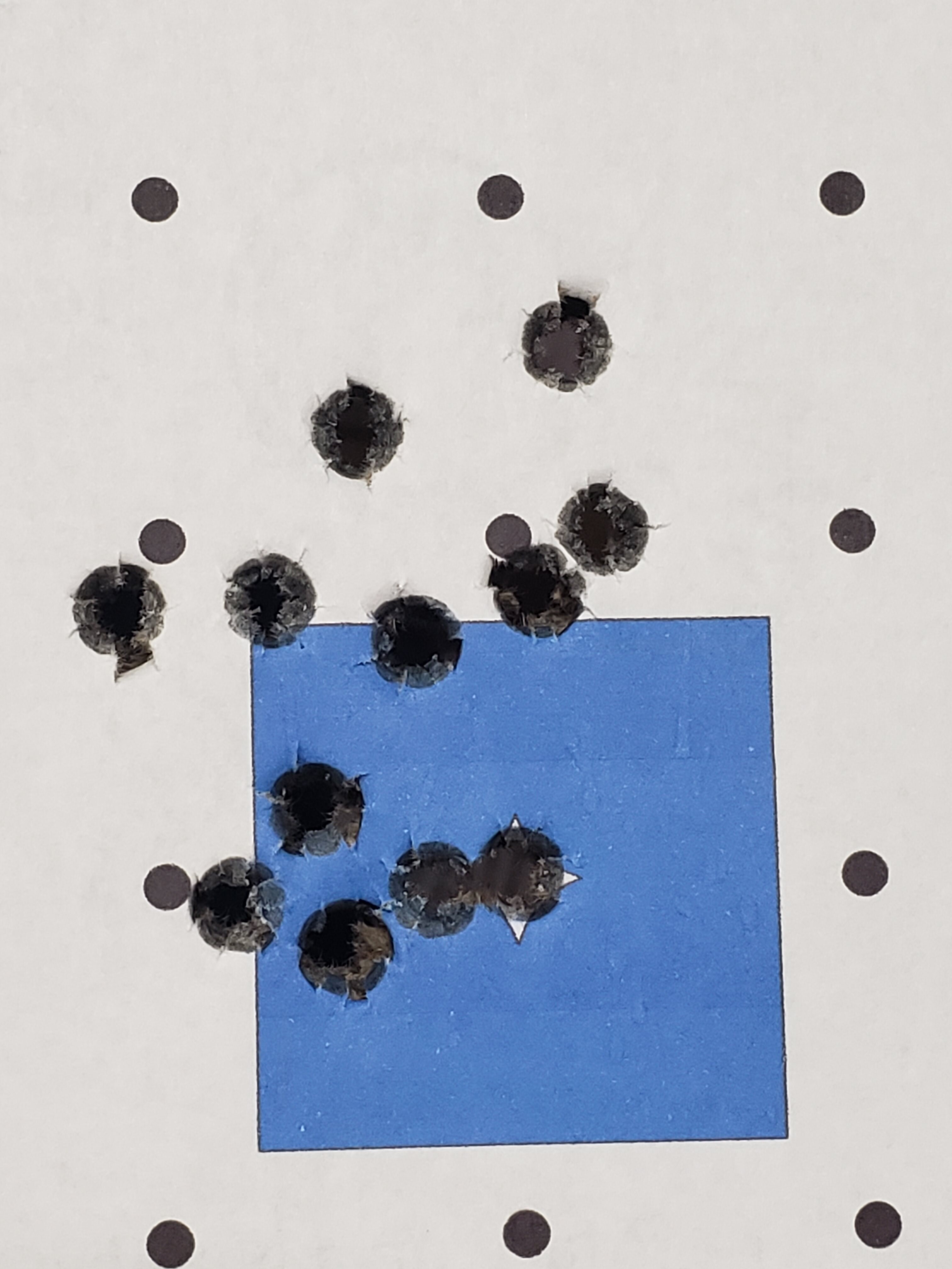

Not 55gr 5.56, but 7mm SAUM on ar10. It is my new toy. First attempt to meet challenge with it.
Fired 12 rounds from fouled cold bore. 150yd. Wind calm. Prone. Blue square is 1.5"x1.5". Dots are 1" apart. 8 hits. Group is 0.7moa R50 and 1 moa R90.
