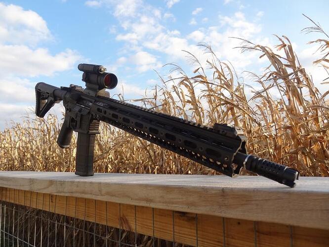

I have the Griffin Flash Comp II on my AXTS build & am a big fan of it.
This is one of the few comps that really works on pencil barreled carbines. A lot of the comps that I’ve tried actually disimproved accuracy… the flashcomp added/corrected that thus enabling me to get some really nice 1moa and under groups with my lightweight setup.

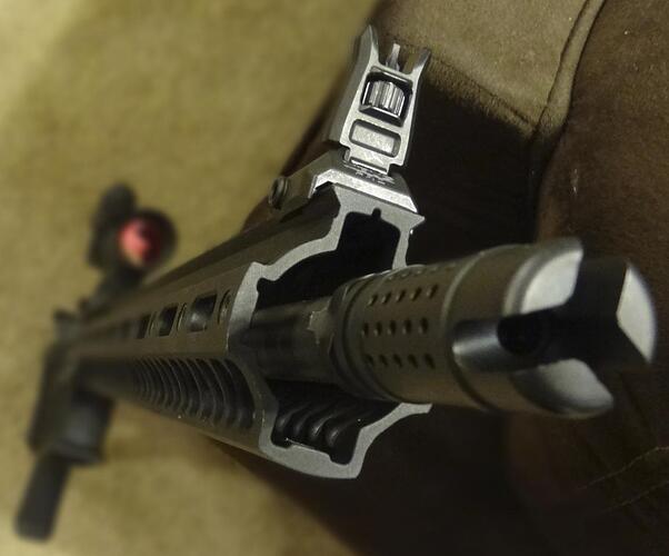

I’ve been using Flash Comp II’s on two 16" mid-lengths for a few months now. Both started with A2’s, and one had a Miculek brake at one time. I’ve shot other competitor’s models as well fyi. I found that the flash suppression was acceptable, but not great (not an A2/Vortex/Phantom). During night testing, there was a small orange plume with some “streaking” particles. Through my Aimpoint, I had no issues with losing vision or seeing the target, but my fixed front sight may have helped to block some of that flash from my eyes, too. It’s brake effect was not outstanding, but it’s there. It’s compensation was very good. It shot flat, but that was also dependent on my hold. I prefer a thumb-over-handguard hold and I noticed a slight bounce off to the right after each shot (I’m right handed). If I hold the vertical grip not as a handstop but as a solid 6 o’clock grip, it stays on target, which tells me my offhand is inducing slight pressure to the side. On my other carbine (more for fun than serious business), I timed the Flash Comp to about 2 o’clock which mitigated the sideways bounce, however, switching hands produced the opposite effect of exaggerated dot movement, naturally. I’m still playing with it, but my BCM fighting gun stays at 12 o’clock. If I had to guess, at 50yds, the dot would bounce about 9-12" to the right. I’m practicing to cure this with better technique.
Overall, I really like the Flash Comp. It has excellent reviews, as do other quality products from different manufacturers. It does everything well, but nothing exceptionally. The comp effect is where it shines IMO. I’m sure you’d be also interested in knowing (subjectively) that when I shoot in the wide-open outdoors, the A2 had a very loud crack, but not enough to make my ears ring (single shot/no ear pro), but the Flash Comp did make my ears ring with the first shot. This may not matter much indoors during a HD situation either way, but I wanted to make note of it.
