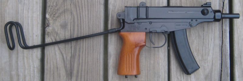

Have you shot a Scorpion before? Can you compare the two?
Assuming that you’re talking about the new CZ Scorpion, no I have not. It’s on my list of things to do, but I just have to find someone who has one.
On the other hand, if you’re talking about the original iconic vz.61 in 32ACP (I know you’re not), then I have one. It’s fun to shoot, but the Stribog is a much better more modern pistol.
