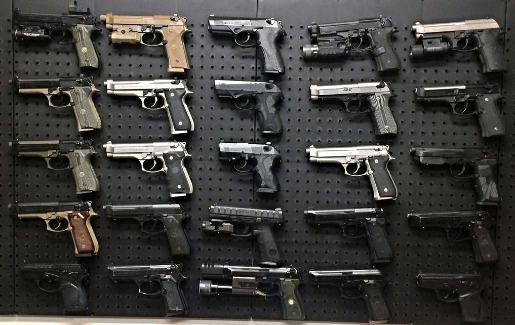

Will it be going into an aluminum body or a Nitrolon one?
Both.
I am upgrading both my M9 Laser Technolgies direct mounts, (like you see in the bottom middle), the later after they became Surefire TG Mount versions like you see in one of the top row guns,

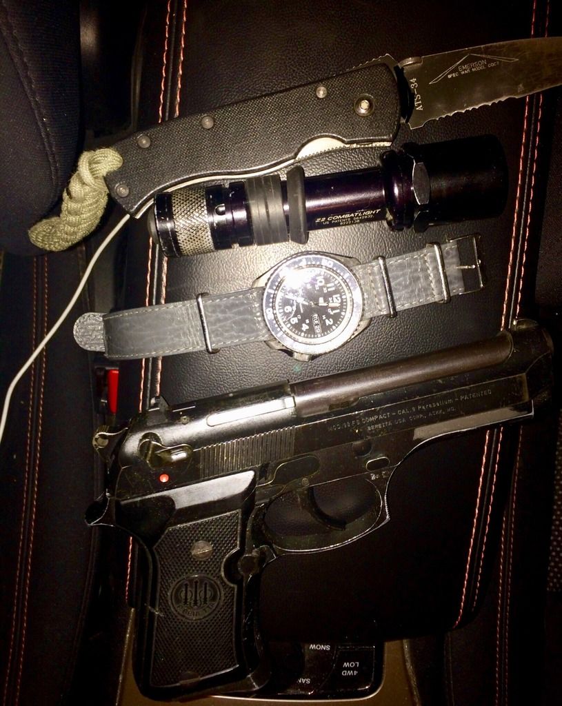

hand held combat lights,
Like this era-
