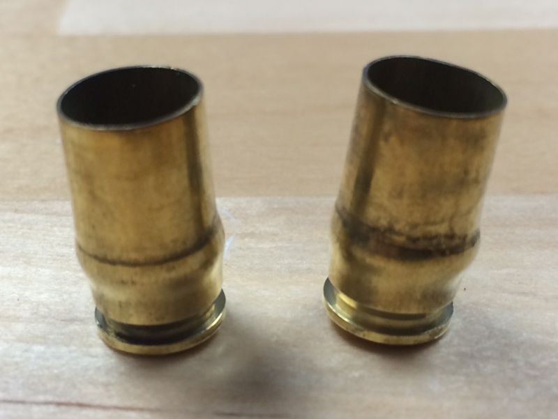

The construction of 40 brass has also gradually been improved since inception of the cartridge.
Early Winchester cases had little to no radius joining the inner wall of the case to the head. I would commonly find indications of the wall tearing away from the head of the case. Headstamp is WINCHESTER 40 S&W. Newer brass marked WIN 40 S&W has better construction.
Other ammo makers had some issues too but the Winchesters were the ones I found most often.
Here is photo of the inside of an old-style Winchester case that has started tearing:
The crack is large enough that a narrow strip of aluminum foil could fit into the gap.
