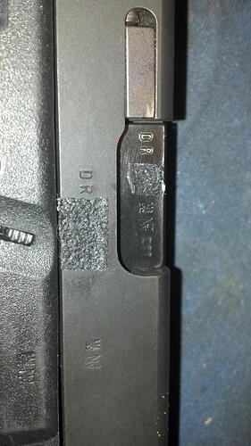

Ok I know I posted about moving away from Glock, But I actually found a hard to find glock 19 gen 2. with Austrian markings too, so I snatched up. Judging buy the serial # on the bbl, the prefix is DR with 3 digits, along with the Austrian proof markings and ZTT from what I gathered it was manufactured in 1988.
and maybe hard to find too, Anyway, I noticed it has pre “upgrade parts”
which I read about was a 6 point upgrade. Anyway as you can guess, Where can I get these upgrade parts? I was able to buy a few on glockparts.net I don’t want to send into glock. as they’ll just replace the slide
and new parts and bring back brass to face. I was wandering If I should just put in newer parts or is there “new old Parts” to replace with I like to keep the original recoil spring assembly , but they don’t seem to replace the old ones with removable springs. Also there is a Pre EH trigger bar on glockparts.net they sell, but Is that the right upgrade? Should I just go with newer parts?, If anyone can give me feed back Id appreciate it sorry for the long drawn out post

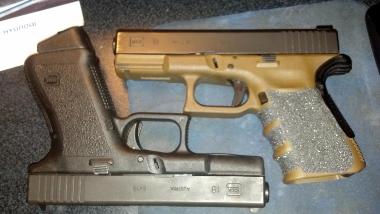

Thanks for the responses, That last picture is with my gen 3 which gives me btf, I was thinking of swaping out the parts that are needed for the upgrade, EXCEPT the extractor, just not sure if they would all fit being its 26 years old
