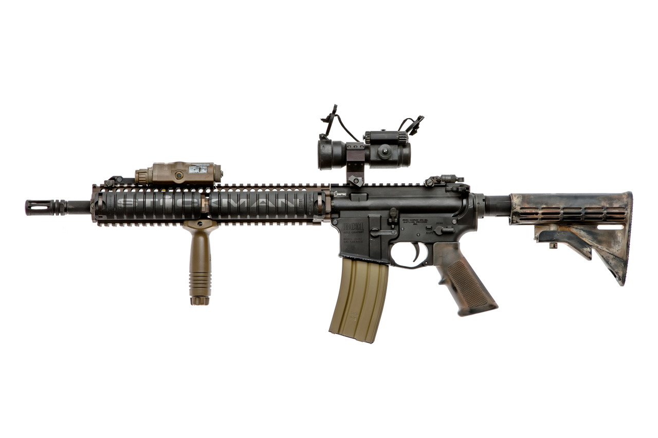

After much seeking I was finally able to locate some of the new USGI tan magazines with blue followers for use with the new(er) M855A1 EPR. The magazines are made by Center Industries and were manufactured 06/15. The body is an FDE color and features a blue anti-tilt follower. Following the footsteps of their previous magazine boondoggle they are continuing with the reversed follower design. They weren’t exactly cheap, but I wanted them as part of my magazine reference collection. I’ll take some additional pics and post them later.

The feed lips have been modified to perform better with M855A1, as far as I can tell by just unscientifically holding them next to each other, the new mags feed lips start slightly to the rear of the previous version, but retain the same geometry. I assume this is to allow the round to have a more upward tilt as it enters the chamber. Our unit received a few boxes of them when we were fielded the M4A1.

Is the finish smooth or have somewhat of a texture to it? Hard to tell from the photos.

Might be a single run, but the Center Industires Tan body, blue follower mags my Battalion got were junk with M855A1. They attempted to minimize the exposed tip hitting too low during during feeding by angling the cartridge up. This raised the tip, but lowered the base of the cartridge. This then results in the the bolt riding over the back of the cartridge and either causing a malfunction or a click when you want a bang. This happened in at least 3-5 weapons that I know of, in one Infantry company. Could be a combination of wear on the M4A1s, but whatever it was, those with PMAGs did not and have not had a problem with feeding. I wrote memorandum on the subject and its made its way to Ft Benning. It was converted into an article on Primary and Secondary if you are interested. https://primaryandsecondary.com/why-pmags-are-better-than-aluminum-usgi-mags/
