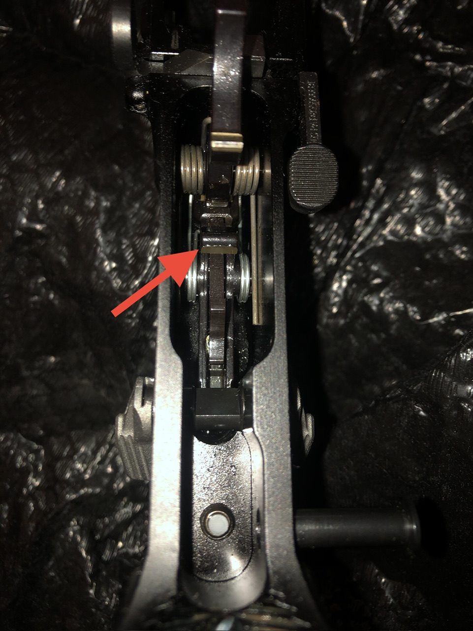

Geissele gritty first stage SSA-E
I have roughly 12-14 Geissele SSA-E’s (installed way more for friends & colleges), itÂ’s my favorite overall trigger. However this last one has a gritty, rough sandpaper like first stage take up, and then breaks as normal on the second stage like an icicle. Does anyone know what could cause this? I saw a long, rough burr line on the sear, and also, the hammer has worn off its coating only on one side and not on the other (the first and second stage doesnÂ’t stand up straight, it has a slight canÂ’t to the right).
Installed on a Aero mil spec lower for a SD build. Anyone ever experience it? Geissele told me to ship it to them on my dime and theyÂ’ll look at it, but IÂ’d rather fix it myself (if possible). If this is supposed to go in the technical discussion I apologize, IÂ’m new here. Thanks.

ItÂ’s hard to see because of the resolution but you can see a burr, like when sharpening a knife. IÂ’m sure theyÂ’ll take care of it. All their stuff is perfect imo.

Thanks guys, I’m definitely sending it back. But just out of personal curiosity because I’ve installed & own so many & so do you, from the photo, what do you think it is? Do you think it’s the rough metal burr line I pointed the red arrow to on the sear? Or impossible to tell if not in person? Just curious what you thought might be the cause because many of you guys installed even more than me. I don’t mean to nerd out, but I can’t stop contemplating what the cause it. Thanks.
Put it back in a lower, pad the hammer strike, and observe. If it’s the burr it should be readily apparent. A Geissele with a burr is no bueno anyway. Canted hammer could be the lower, whatever. Some f***y shit going on there, may be more than just Geissele, just sayin.

Everything you said makes 100%. I thought of the lower being out of spec, thatÂ’s why I installed another new SSA-E I already had (I mentioned it above along with the photo) and it worked perfectly. So thatÂ’s why I think it might be the burr. You can clearly see the burr in the photo if you zoom in. I was thinking about filing the burr off but was afraid IÂ’d screw it up and/or void the warranty with Geissele.

Im not seeing the burr, in the first pic and burr that would affect the trigger feel would be on the underside of the disconnector hook not the side, the 2nd pic is the top of your hammer that only interfaces with the underside your bolt carrier, pretty much irrelevant to the trigger pull. Not exactly what you are trying to point at in your 3rd pic. You should be able to feel any roughness with your finger on the engagement surfaces because Im not really seeing anything in your pictures other than your FCG looking like is off center. As Ucas said your lower doesnt look right for some reason. What brand lower is that?
If what your saying about the burr is true (although I have a red arrow pointing to the starting of it) not effecting it because itÂ’s on the other side then I was wrong and itÂ’s something else. However I understand what your describing about the hammer only having wear on the very top (thatÂ’s how all my other GeisseleÂ’s are too - just the normal wear from rubbing against the bottom of the Reciprocating bolt carrier - however if you look at the second photo (itÂ’s taken sideways) the wear is only on one side going from the bottom to the top (IÂ’ve never seen that before) but again, that may not be the cause of the issue (IÂ’m just guessing asking for your guys opinions). On the third photo youÂ’re absolutely right, it is off center (my other GeisseleÂ’s are all dead center). However I installed the trigger in two other striped lowers and it was the exact same off center (those two striped lowers was an Aero and a Spikes tactical). The original lower was a stripped Aero lower (with one of those PDQ buttons installed from
Aero, not me). So maybe itÂ’s gritty because itÂ’s off center (maybe a bent pin, something else - I donÂ’t know, just guessing).
