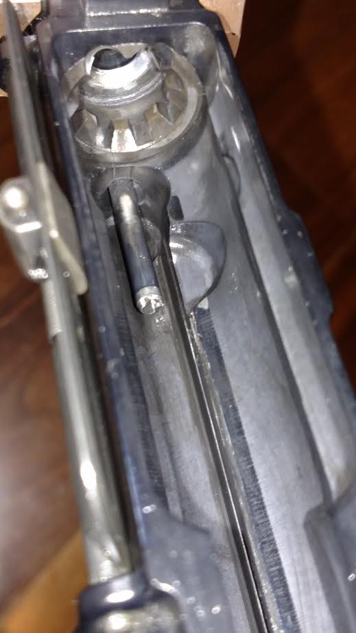

Here are the promised pics. I know it doesn’t look terrible, but it certainly was enough to prevent the bolt from going into battery.
Not sure what happened there. Looks like the key rammed into the tube. Time for a new key and gas tube.

It’s a bit hard to tell from the pictures, but it may have been a loose primer wedged between them.
Check some of your fired brass for missing primers.
The tube should be replaced for sure.
The gas key MAY be fine with a little clean up, depending on how deep the damage is.
