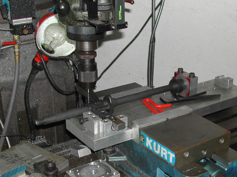

Another solution is to have a good AR gunsmith pin your FSB to the barrel.
Make sure they have a good fixture like this one to align it correctly:
