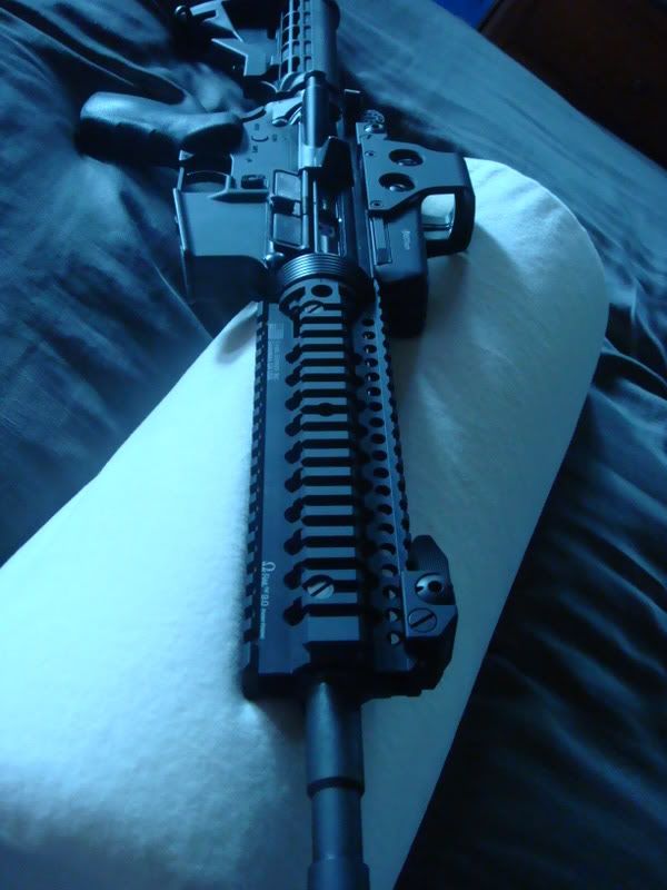

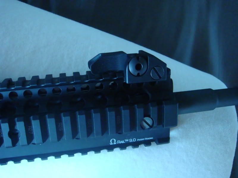

Here are the pics:
This is an OMEGA 9.0 on a BCM midlength. There is about 3/32 of an inch space between the handguard cap and the rail. Also, as you can see from this angle, due to the narrower profile of the DD rail you wont be able to slide accessories onto the side rail from the front without doing a little trimming. Obviously things like LT mounts that clamp over the rail have no issues. The OMEGAs mount on the barrel nut and have set screws that square the rail up and tight via pushing on the front of the barrel nut. They do not mount to the handguard cap.

kukang,
Did you have much trouble getting that shaved FSB under your Omega rail?
I’m really curious as to whether or not you had to shave the pins also. The Omega seems to be a pretty tight fit.
thanks much, Sam F
Yes, I had to shave the pins down flush. You’re right - it is a very tight fit but not hard to do.
You don’t need the handguard cap to use the Omega. It works just as well without.
