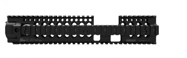

Daniel Defense Omega X Rail
Daniel Defense Rail Interface System (socom uses this)

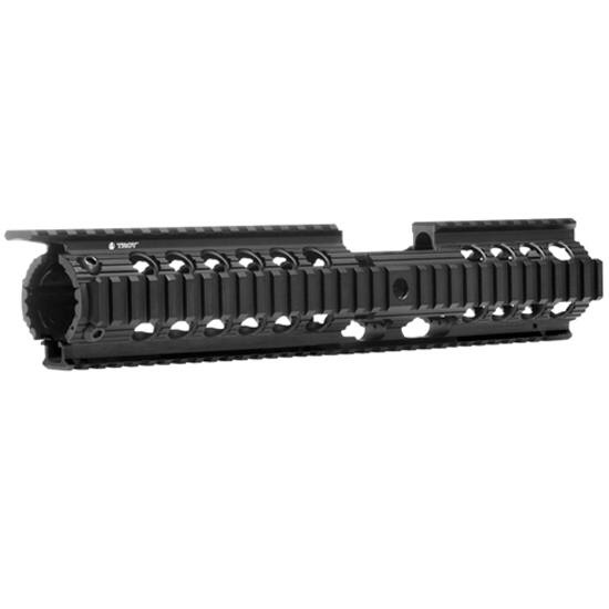

Troy MRF-CX Battle Rail (uses stock barrel nut)

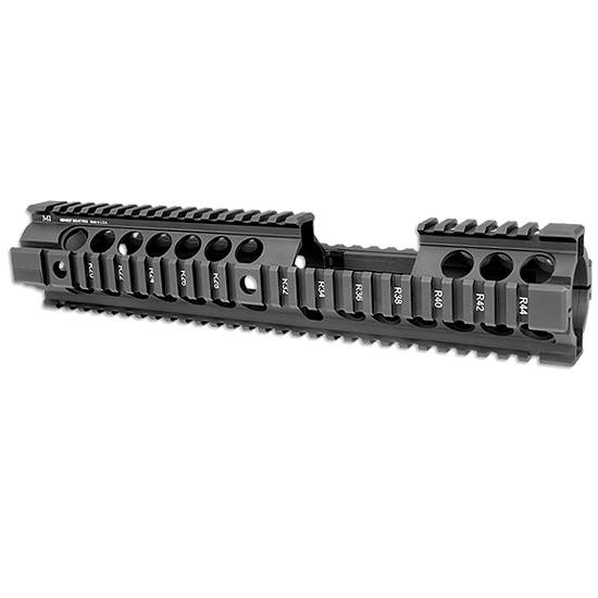

Midwest Industries MCTAR-20XG2 (installs over stock barrel nut)

I have the Omega X rail and it’s nice but heavy . Though I plan to take mine of and shave the front sight to get a lighter gun. I will add a Daniel’s Defense front sight to finish it off.
I use the Troy Charlie rail. Its fine. A little heavy. I beleive its the only one thats “drop-in” and doesnt require the removal of anything. And I have the shorter mk18 RIS II rail and I think its alittle wide but I like to wrap my hand around the rail. If thats not your style then it shouldnt matter.

Well that rules out the Omega X and the RIS and the Midwest.

Reading the descriptions for install on all these rails is confusing. From the description of the Midwest rail they make it seem like nothing needs to be removed…front sight or barrel nut…and replaced with any thing else…no?
Thanks…as far as weight and looks this might be my least favorite but it seems to a drop in free float. Have you have any shifting issues lose screws?

Removal of Delta ring, which is modifying the rifle, it has to be destroyed unless you disassemble everything.
http://www.midwestindustriesinc.com/index.cfm?fuseaction=category.display&category_ID=422
Second line down

I would go with the Troy Delta rail. It is similar to the Troy Charlie except it is a tubular rail instead of a quad rail and it is lighter. I purchased mine from Primary arms for $200 and IMO it is a great value.

Dd omega rail is drop in and free float. Solid lockup. Can probably find a cheap one on an EE since they’re not in vogue anymore
I did list the DD Omega Rail because I’d have to remove my stock front sight since this model rail doesn’t seem to offer the cut out I need to keep the front sight.

I had it shift once and it was completely my fault. I did not use loctite at first. I reset everything, added loctite and really tightened the screws and its been good ever since. Ive had it for close to a year now. And as far as it feeling heavy Its definately still do-able. Theres just lighter options. Mine is a work gun so I cant make “permanent” mods to it or else Id go with one of the free-float fsb cut out rails.
