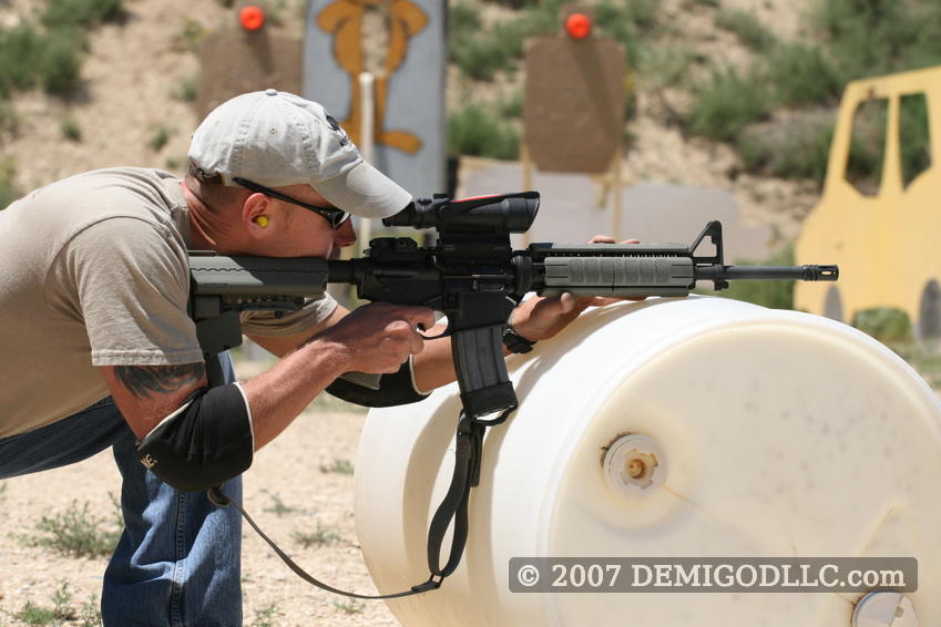

I also found that Daniel Defense 9.5 FSP rail will give a little extra real estate to support the barrel on a barricade on a carabine length upper. Of course the 12.0 mid length DD FSP rail will do the same to middy upper :slight_smile:
Personally, I’ve never found the 9.0 to be lacking in real estate when resting on a barricade (and don’t think 0.5" would make much of a difference):
I have found numerous positions where the 7.0 is too short. I have never found a barricade / obsticle that has presented a problem with the 9.0. I have never “needed” anything longer than a 9.0. Perfect length in my opinion.
If the handguard is long enough to rest on a 55 gallon barrel with a 30 round mag inserted, there isn’t another barricade that I can think of that will present a problem.
In my opinion putting a 12.0 on a 16" barrel isn’t really doing much. You are paying more for the longer rail, adding extra weight, and getting not an ounce of gain in performance / balance / stabilizaion on a barricade for the extra cost / weight.
Just my personal experiences, your milage may vary.
