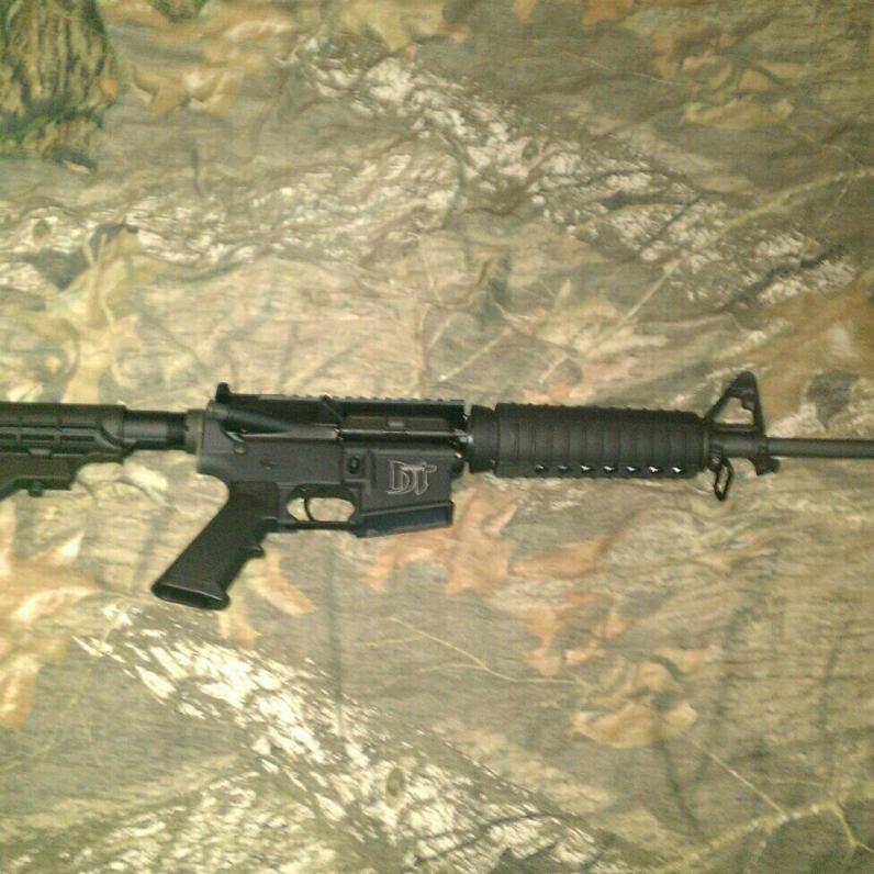

Best option for getting rid of a fixed front sight on a rifle. Am I able to just take it off?

well im looking to purchase an EOtech sometime in the next week and heard that the front sight is more of a distraction than anything. ive been using a red dot on it for the past year and lined it up with my FSB and it worked out ok. just not sure if it will be best to have it once i put on an EOtech.

No, you can’t “Just take it off.” It also serves as your gas block.

I don’t see a rear iron sight in your picture. Have you been using your RDS as a “rear sight” all along? It really sure seems like you have, unless I’ve misinterpreted what you’ve been saying. If so, I apologize. If you indeed are, well, then you’re doing it all wrong.
You need a rear iron sight to use with your front sight. They work together. An RDS is another, completely separate redundant sighting system. You don’t use a standalone RDS as a rear sight to line up with your front sight. Is this what you’ve been doing?
You will need to punch out the 2 pins on the bottom of the sight and then replace it with a gas block. You will also need to remove the muzzle device in order to slide it off the barrel.
