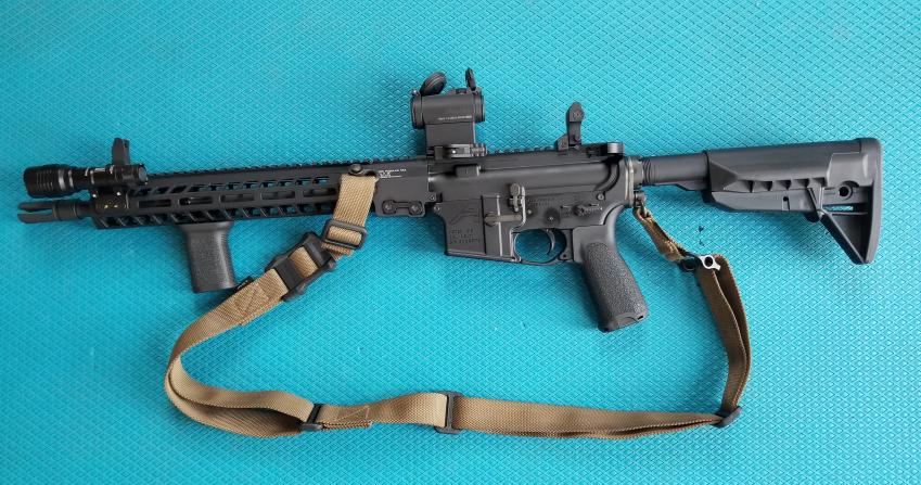

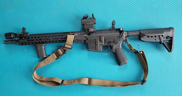

This is the first AR-15 that I have fully assembled on my own. The whole project started almost entirely on accident. I bought an ALG lower parts kit on super sale, and then stumbled into a great deal on an Aero Precision receiver set. Oh shit, I said to myself, it looks like I am building a rifle… For a while, I was waffling on what barrel to get: a Ballistic Advantage CHF CL 14.5" for the durability and their purported accuracy, or a Noveske Afghan 14.5" stainless steel for the reknown precision even over the course of 20,000 rounds. I found the BA barrel on sale, and moved forward.
As it stands, the current upper mounts an Aimpoint T2 on an ADM to go along with the BA CHF CL barrel. The twinned upper, which parts are en route to me now, will mount the Razor 1-6 along with the Noveske Afghan. That configuration should be able to let me take the 556 round out to 500m and beyond. I’ll update the thread once that upper is complete.

In closing, if you made it this far, thanks for reading. This was a helluva project. I can’t thank the fellas on this forum that helped me out enough. In particular: ContaxShooter, Docsherm, Eurodriver, GTF425, Mr. Goodtimes. You all either provided material support and/or were incredibly patient with your responses to my (too many) questions. With the completion of the second upper, I should be essentially done. I’ll have a light weight red dot upper that will reliably fight out to 300m, and a precision upper that will take the effective engagement range out to the very limits of the 5.56x45mm cartridge.
I’ll update the thread once I get the Afghan upper put together.

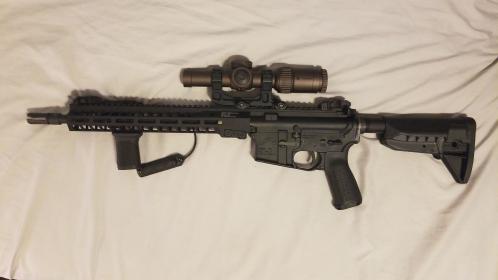

With that optic bridging the upper and rail, it will lose zero/fly off the gun the first time you shoot it.
Indeed, this build needs a cantilever mount.
So now that we’re done ruining your exceedingly well put together and informative thread… Very well thought out and put together rifle dude. This rifle embodies everything a good general purpose rifle should be.
Yeah I’d recommend extending the stock and moving that optic back. There’s hardly any reason to use an optic mount to bridge the upper and rail, even if it’s a solid rail.
Note bene regarding the current photo: the super precision mount was used to time the rail to the upper during installation. The Razor HD 1-6 will be on the Afghan upper, which is yet to be assembled. The current build will use an aimpoint T2, but I do not yet have the mount.
