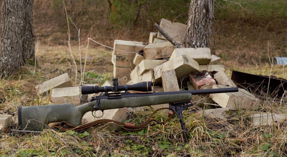

I put this together this week after buying a 700ADL tactical. Its at 10.8lbs with bipod, sling and everything else. Its manageable and could be lightened with a better stock. So far it shoots good, starting load development this week. Dumped the trigger, stock and what not. Dropped in a BC stock, and pre-recall trigger, and floorplate.
