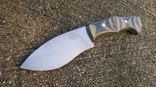

I dabbled in knife making years ago using little more than hand tools but recently got the itch again and saved up for a real grinder. After spending enough for a good used car and trashing enough steel to make a scrap yard jealous I finished my first two.
They are both flat ground from 3/16" Starrett O1 with G10 scales. The first is multicam - layered with various combos of black, brown, green, and tan. I’m not a real fan but some folks seem to like it.
Second knife has tan scales. I didn’t get a shot the first’s sheath before I gave the knife away. Let me know what you think.

I really like the finish on the blade of the first knife. How’d you get the “stonewashed” look?

Thanks for the comments. bprice, both knives have a tumbled finish. I tumbled them in a home made tumbler consisting of a five gallon bucket attached to a frame with a motor. Works well and will let me tumble much larger knives than a vibratory reloading-style tumbler. I use 3/4" aluminum oxide tumbling media that is fairly aggressive.
On the first knife, I etched it in ferric chloride before tumbling. It darkens the blade and gives it even more corrosion resistance than tumbling alone does. It does give the knife a vintage or worn look. It makes for a fairly easy to maintain finish that doesn’t show wear too easily.

Here’s one I finished up for my brother in law…a bit smaller than the first two and the tip is dropped a bit. Flat ground from 1084 carbon steel with green/black G10 scales and stainless hardware. I tapered the tang on this one so it’s nice and light, noticeably more than the previous two even though it’s the same thickness. Unfortunately, I didn’t get a shot of the tapered tang. Like the first two, this one was hardened to 58/ 59 HRC for good edge holding and fairly easy sharpening.

Lastly, here’s one I just finished for myself with some old green/brown canvas micarta. It’s my neck knife/ small knife design but I wanted it with sculpted scales so I used the micarta I had sitting around. It is 7" overall with a 3" blade. The false edge stops short of the tip so that the tip remains strong. I used extra small eyelets on this sheath to make it minimalist. It doesnt have the variety of mounting options but I didn’t care since it was for me.
