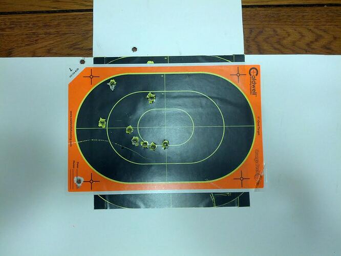

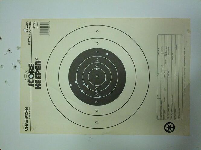

I’m a new AR owner and I’m still in the process of learning irons and the zeroing process. I am trying to zero at 100 meters. Please see pics and critique as necessary.
Five shot group at 50 meters, sighting in: (ignore the bottom 4 holes, my 14 y.o. sister shot those - first time with an AR too at 50 meters!) I’m not allowed to shoot rifle at 25 meters at my range, sight in at 50 with a few rounds only, then move on to 100 meters.
Nine shot group at 100 meters. I don’t know which one is the 9th, either top left or bottom left. The other hole is from another shot group, I overlaid the orange stick on target on my previous group. Black oval is 7 inches wide by 4.25 inches tall.

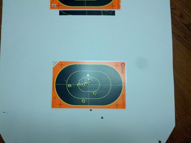

Ten shot group at 100 meters. Black circle is 5.5 x 5.5 inches.
My POA is at the bottom of the target. So the oblong/circle is sitting on top of my front sight post in my sight picture.
What baffles me is that my POI at 50 meters seems about the same as my POI at 100 meters. Also, as per LAV in his Tactical Carbine video, your shot group at 100 meters should be tight enough that you can cover it with your fist. How do you “zero 2-3 inches high” at 100 meters if the group is that blown up? Just base it off the lowest shot?

Your groups are favoring left low. I would adjust front post down a couple clicks and rear sight right a couple clicks. Then practice bunches. Your groups with iron sights on paper will cause you to beat yourself up. Don’t get frustrated with groups that seem large. Try different brands/weights of ammo and see if there is one your rifle likes better than the others. What twist is your barrel & what weight were you shooting that day?

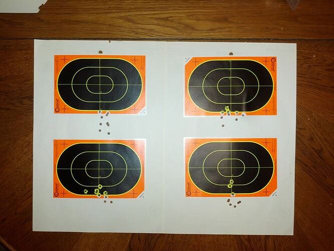

The 3rd target is not in the right orientation. Do you know how I can flip this right side up? That’s the other thing, every shot group has a different pattern, so it’s hard for me to diagnose. Maybe I just need more trigger time.

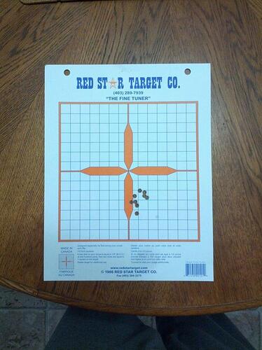

Like, look at this one…they’re low right, although this was shot at 40 yards.

55 grain is fine for your 1/9 twist. Maybe try some 62’s and see how they group. According to your last pic I would still lower front post a couple but I would move rear sight left. If you want a 100 yard zero it needs to be a little low on your 40 yard target (bullet is still climbing to reach your line of sight). If you can get it centered and about an inch low at 40 you will be real close at dead on at 100. Work as close as possible to get group centered then move out to 100 to final tune elevation. Don’t expect amazing groups with a Norinco and iron sights. If I could get a centered group of about 3-4 inches I’d be happy with it and consider it done.

Are you referring to the pic with the black circle? Or the one I shot at 40 yards? I understand the trajectory and I’ve read the 100 meter zero thread. I just posted that to show that my groups are showing up on paper with different patterns. Even the two groups at 100 meters are grouping differently, and my first group (the one underneath the oblong target) also had a different pattern where there was basically a bit of vertical stringing forming an arc from about 7 to 10 o’clock position.
