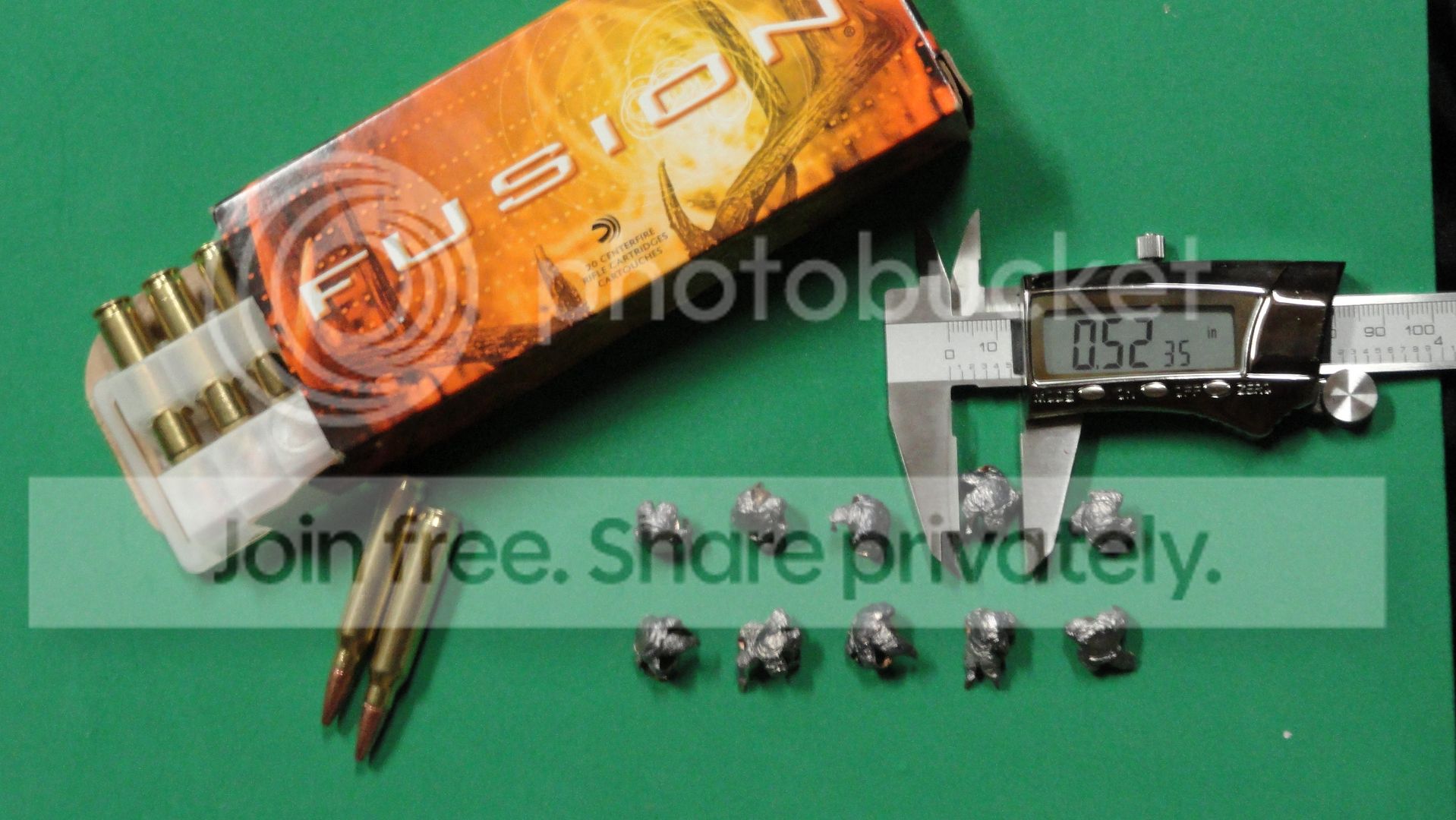

I’m not sure there is a better all around performing round for the price than Fusion, and if there is I haven’t found one yet. The terminal aspects of Fusion are well documented, but it’s unusually accurate nature (for barrier blind loads) is far less documented, and discussed. It’s very accurate especially considering the projectile it’s using. Out of all the true HD ammos I charted on paper, it’s certainly the most accurate out to 100yds.
Anything that is good with regards to being barrier blind will be effective on both blind, and unobstructed targets.

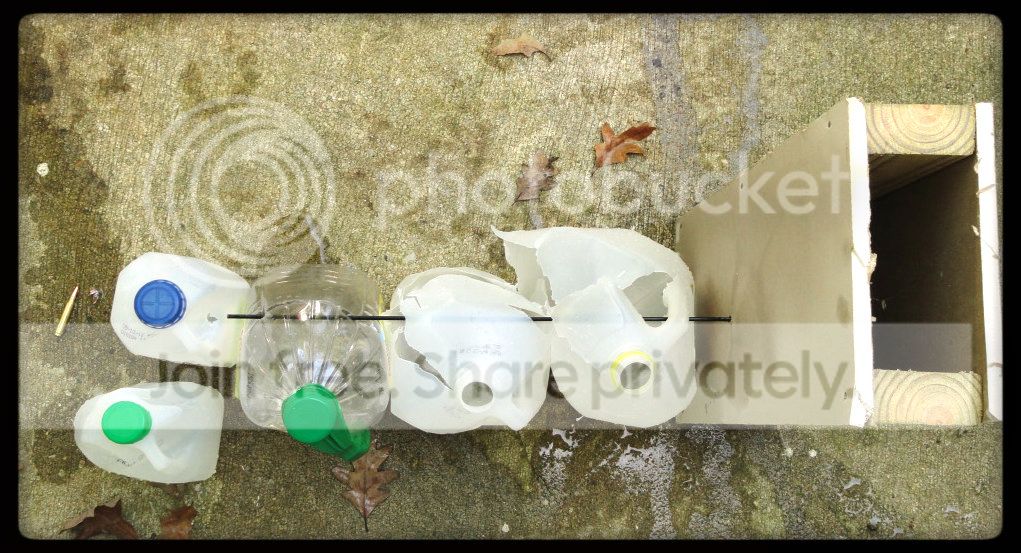

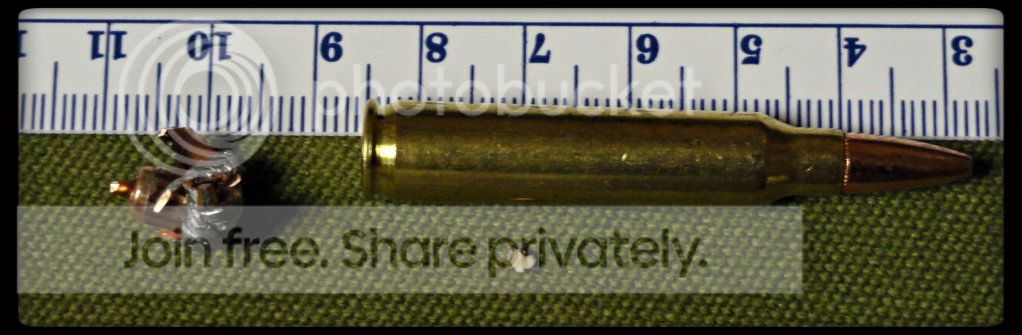

To give you an idea how consistent, how much expansion, and those effects on an unobstructed medium (in this case, a DIY bullet water tank was used). I hope my old photobucket pics show up for you…if not I’ll try and post them using imgur.

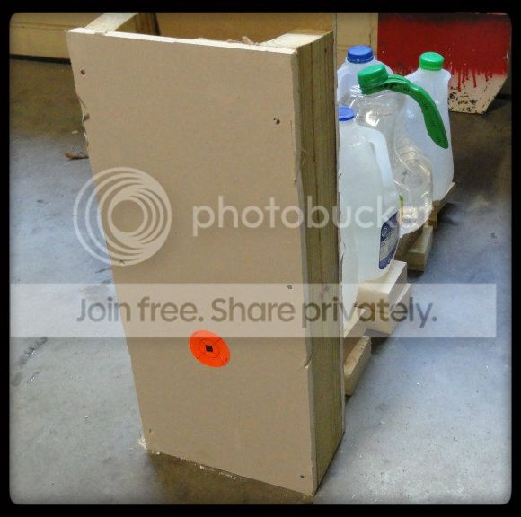

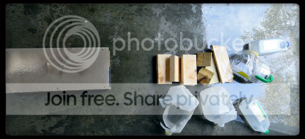

EDIT: Compare the unobstructed recovered rounds with the one recovered after a sheet rock test I performed…(these tests are taken from a much longer thread I OP’d some time ago)
Sheetrock/wall test…Fusion 62gr…25yds…MRP CQB 10.5"
For comparative purposes(see first post in the OP…fusion into bare jugs @ 25yds), hopefully you’ll note that the fusion remained fully intact after passing through the barrier, where it then exhibited excellent early upset in the first and second jugs, almost fully expanding by the time it reached the third jug…whereby it began to rapidly yaw upwards and to the right penetrating another half jug completely and landing right outside of it.
Short and simple…the wall made about 10% of the bullet not fully expand…thus making it actually drive deeper, and yawing as it ended it’s travel.
This was at least for myself very reassuring to see, and exactly how I had expected this to fusion to perform when encountering a light barrier such as a wall. Sample of one…fwiw.

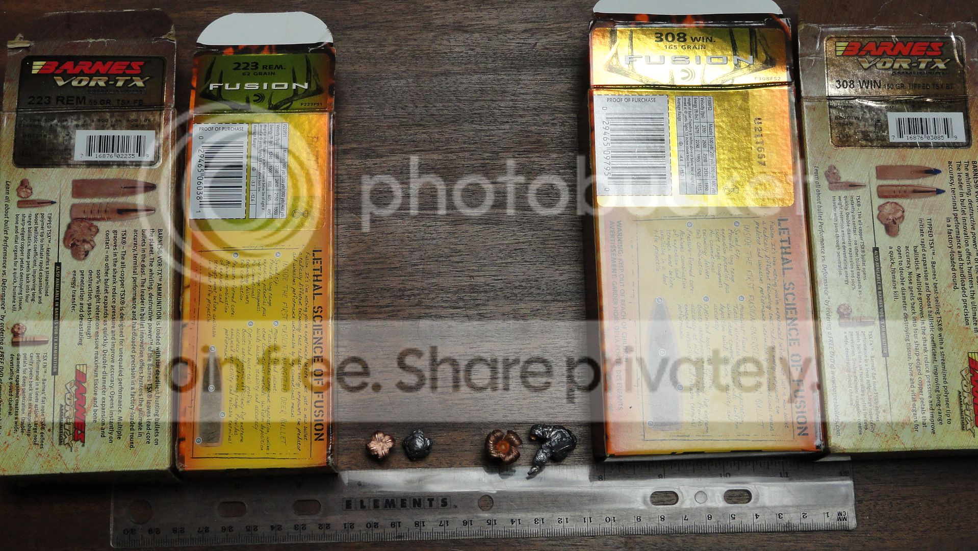

The .308 Fusion is some real nasty stuff :cool:
.308
165gr. Fusion / 150gr. TTSX
VS.
.223
62gr. Fusion / 55gr. TSX FB
I think I would take it over the almost twice as expensive TTSX loading as like PB eluded to, my MWS shoots the Fusion around 1.5MOA, whereas the TTSX was well outside of 2 MOA.
