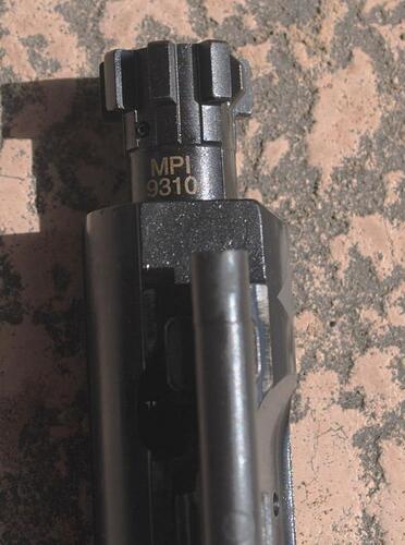

Rainier Arms BCG on sale for $99. This is a 9310 bolt, and given the price and Rainier’s customer service and warranty, I think it’s a steal. One thing I did notice the staking was a little less deep compared to my Colt bolts, but it’s still acceptable. This is more of an observation than a complaint. And yes, MarkM did shear the lugs off a Rainier bolt recently, but, for the price point I think its perfectly serviceable for my dad’s intended use.

Looks real good. Nice work. The only thing I would change is adding a fixed DD or Troy rear sight. I just don’t like a flip up sight as a dedicated sight. Just me…overall nice work. And I would not worry at all about the Rainier BCG, I have several that I have run like hell and they are GTG…only bolt that I have broken was a Colt…:wink:
