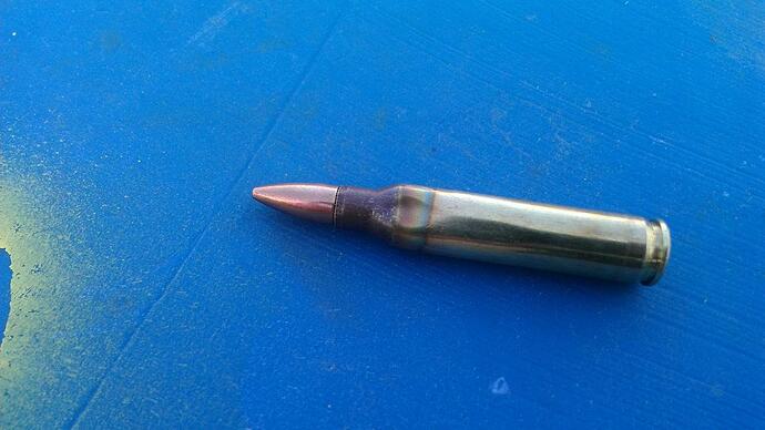

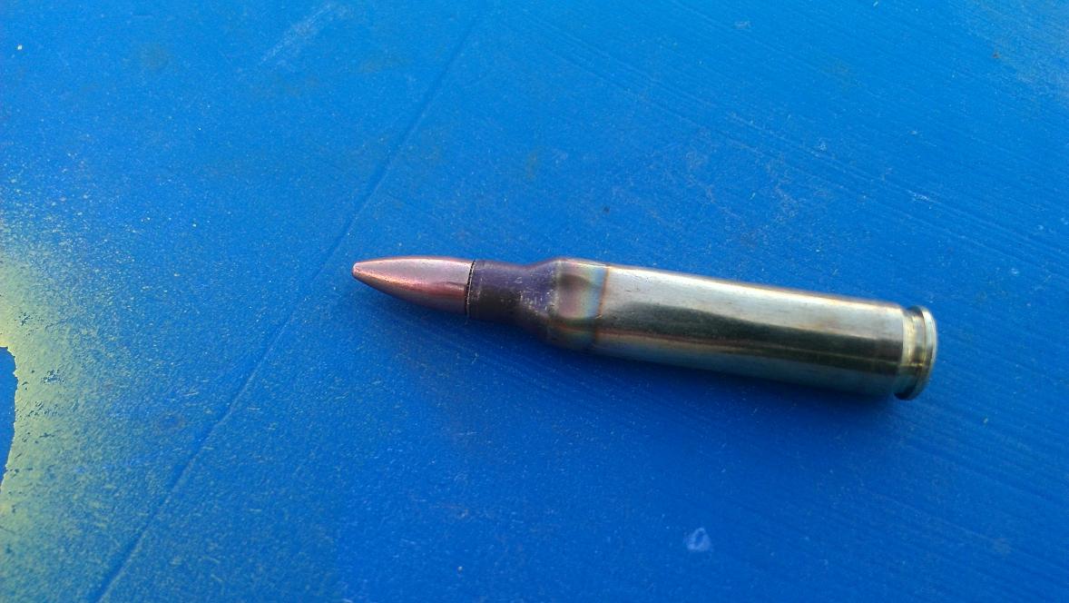

I have a complete BCM upper that I had an issue with today. I’m using Gen 3 Pmags. On the last mag of the day I had two failure to feeds. The round almost fed fine but the bolt was out of battery and the round was stuck. There’s a dent in the casing just behind the neck. I reloaded the mag and it fed fine but I left the range after that.
Any Ideas?

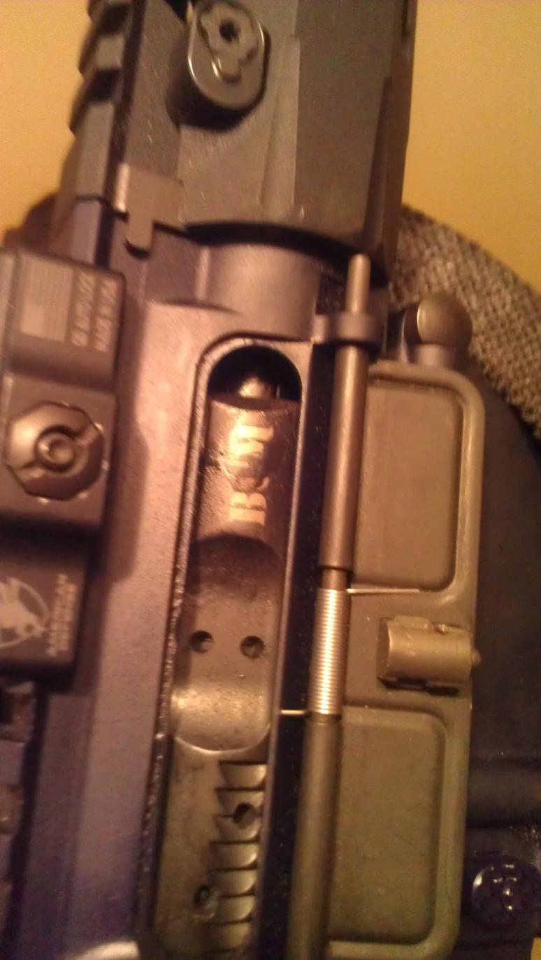

looks like round was chambered, kicked out (rifling marks on bullet) and brass deflector dented the case causing damage leading to ftf.

This happened in the middle of a mag, it didn’t hit the brass deflector very hard cause I had to step on the charging handle.

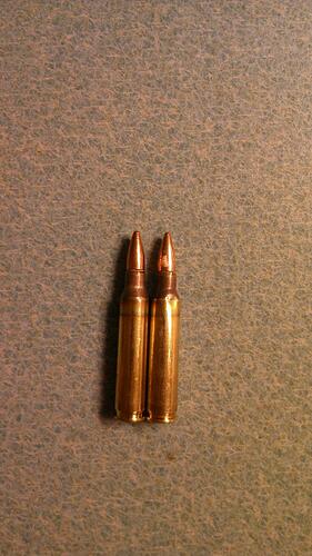

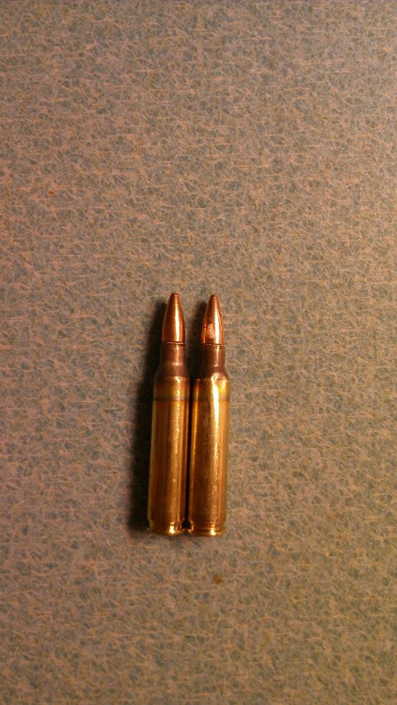

What’s the overall length of the cartridge? May be the angle in that pic but the neck looks a little long. Can you put that cartridge side by side with a known good cartridge?
Random from same Lot on the left.
Thanks for posting the pic. I don’t see any major differences. Is it possible that your weapon is dirty and running a little dry?
