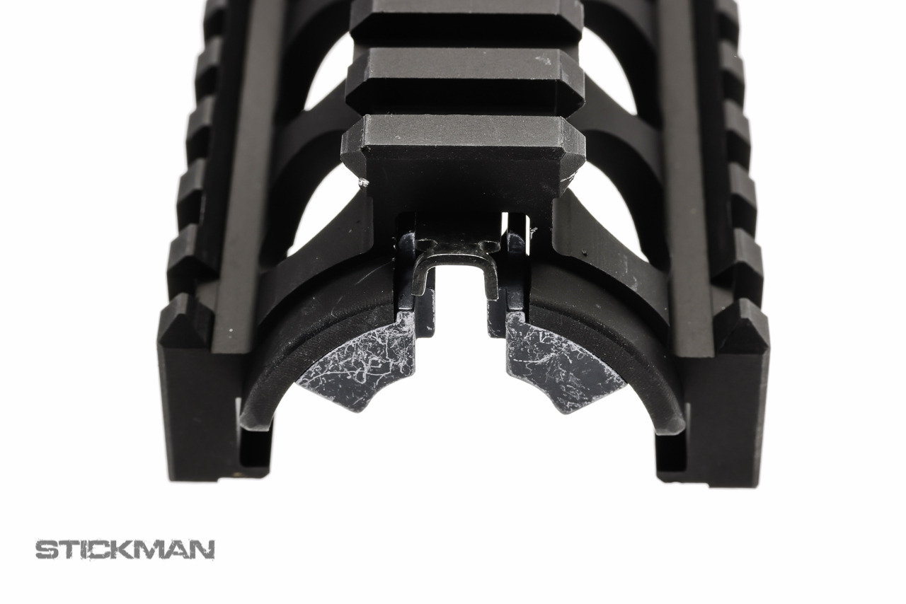

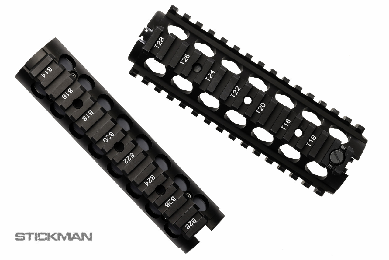

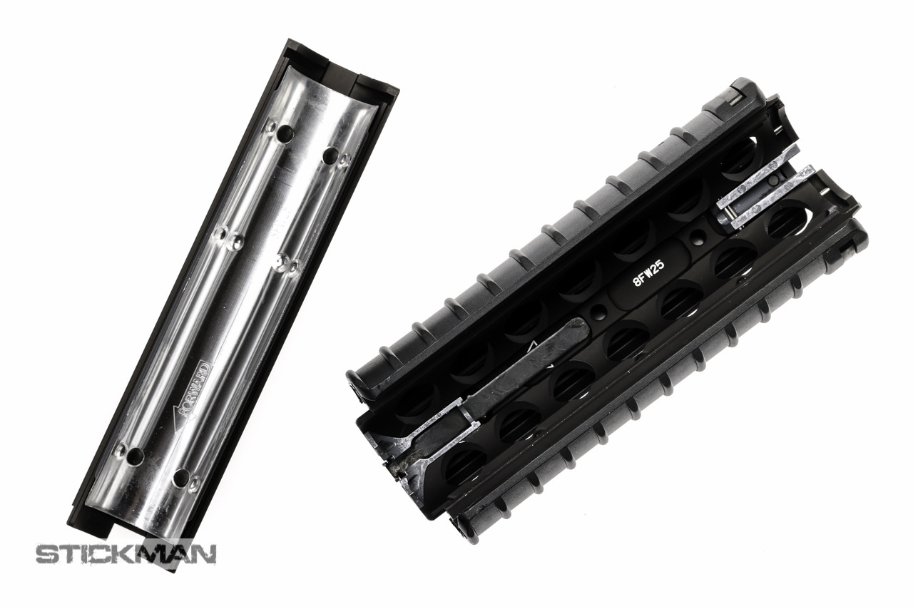

Popping the rails apart and examining the inside, the heat shields are sturdy and unmarked with anything other than the “Forward” stamping/ engraving. The upper rail shows no obvious shortcuts, and the two metal ends for aiding in attachment are in order. Nothing out of the ordinary here, and again, it all looks well machined inside.

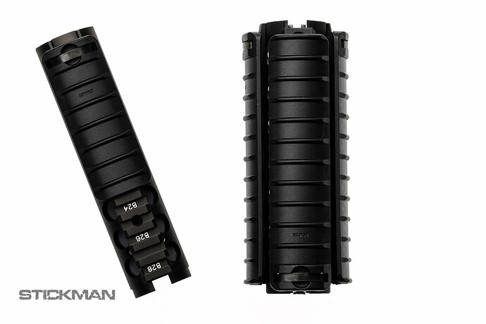

Taking the rail covers off gives us a clearer view of what we are looking at. The first thing that stood out to my eye was that the anodizing was fantastic. It is a deep clean black, with no hints of purple, blue, or contaminates. If you are seeing any color shifts on the display you are looking at, it could be your monitor or viewing device, or it could be the quick processing and resizing slapped on these images, but in person the color and depth of anodizing looks fantastic. If the Expo Arms guys read this, send my thanks to whomever does your ano work, because they did a great job.
Next we look at the size, depth, and cleanliness of the machining. The 1913 rails all look in good order and even. To my eye, the machine work is rock solid. There are no chatter marks, which are most commonly found when a machine is cutting a bit too quickly for the given material. There are no evident tool marks. The deburring work is very well done, which leaves the 1913 sections sharp and clean. When I say “sharp”, I DO NOT mean sharp as in it will cut. I mean the edges are clean without being rounded over. The edges are not like cheese grater, they are square and it is clear the machine work was not done with dull bits or rushed along.
Holes and mounting barrel nut support are clean and positioned appropriately. There was nothing out of place or botched that I could determine.

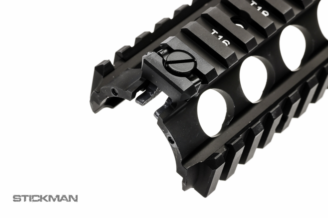

This image shows the section which mounts in the handguard cap. It is as straight forward as you expect. This should not be a shock by this point, but I’ll point out that this is not a newly conceived rail, this is a rail which has been produced in the millions with any issues having been taken care of decades ago. Unless you need KAC engraving, this is functionally the same RAS from what I can tell.
Here we see the end which locks into the barrel nut and delta ring assembly. Again, it is on target for how it should look, all the way down to the darkened screw head. Dust or lint in the pic is from my own place, no extra charge for the viewing…

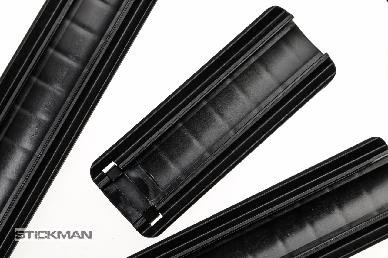

If there is complaint from the cloners, it is probably going to come from the lack of marking on the rail covers. However, the rail covers have nice tight locking tabs, which are blackened and secure well into the RAS when slid into the correct locking slot. Much like the rest of the pieces, these rail covers make do with the simple 8FW25 marking. The covers appear to be a similar material, and have a similar texture on the outside to the original covers. They are not shiny, or glossy and do not look like some of the airsoft knockoffs. These covers will no doubt function fine, though I will say I have not fired this weapon with these rail covers. If the covers get hot and soggy, I’ll update this to reflect that issue, but at this point it does not seem likely.

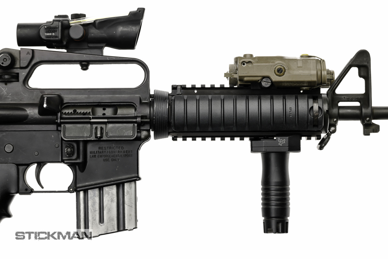

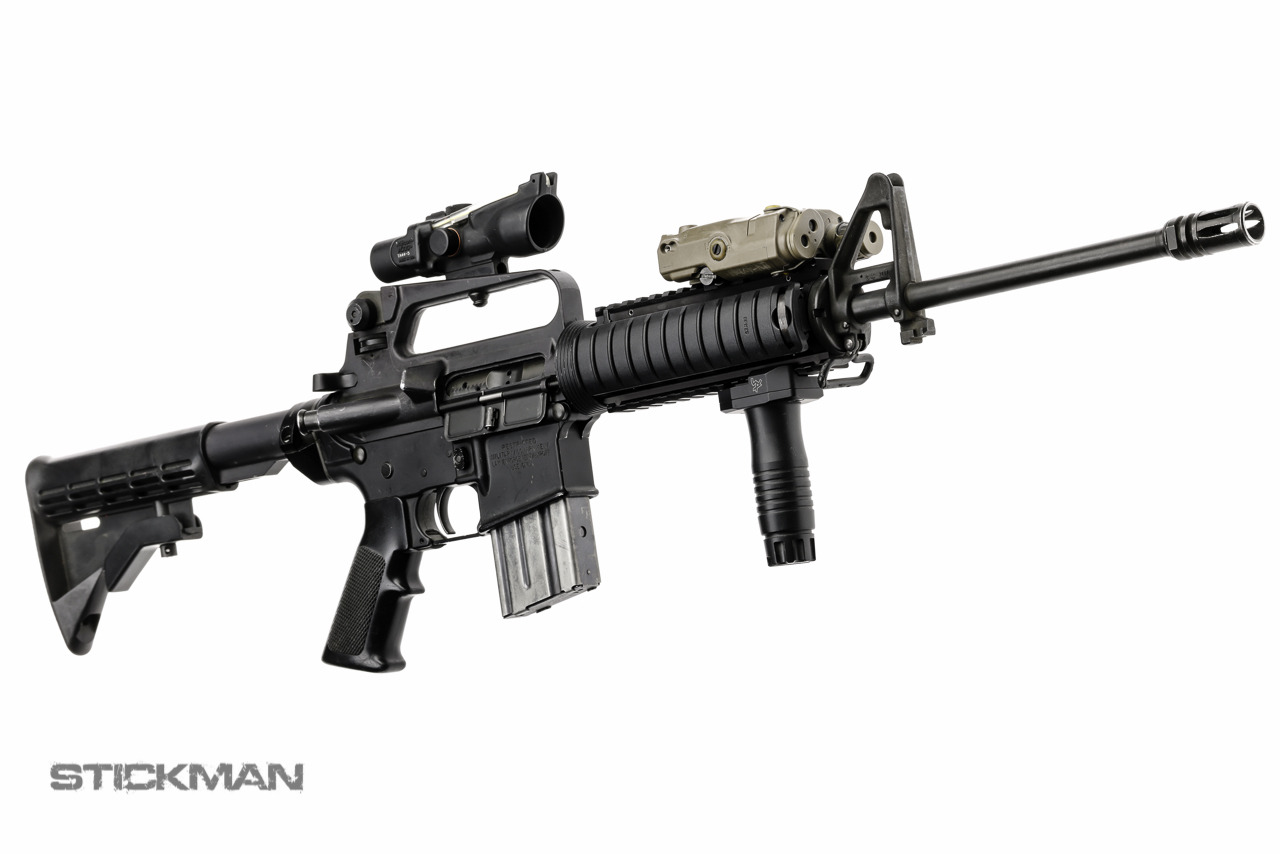

The below image shows the complete weapon, but I’m going to assume most people are familiar with military M4s and know what they look like. The below AR15 is a retired Police carbine that was used for illustration purposes.

8FW25 is the cage code for Prudent American Technologies, which I’m pretty sure is the new name for what was P&S.
I’d have guessed that with 95% certainty, but didn’t want to post that assumption. Same code as Brownells RAS I’d guess. Either way… happy to see these available. Restores a sliver of faith in humanity! :wink:
Absolutely! If it’s any consolation to the closers, the rail on my assigned weapon which was a new Colt M4A1 (circa 2020 or so) was P&S.
Fantastic! I appreciate the info. I wonder if they are making them for P&S, or if they are just leasing the contract (or something similar).
