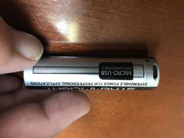

I have been using the streamlight batteries and charger for about a year now with no issues. I like that the batteries have a micro USB port built into the battery so it can be charged from my phone charger in a pinch.
