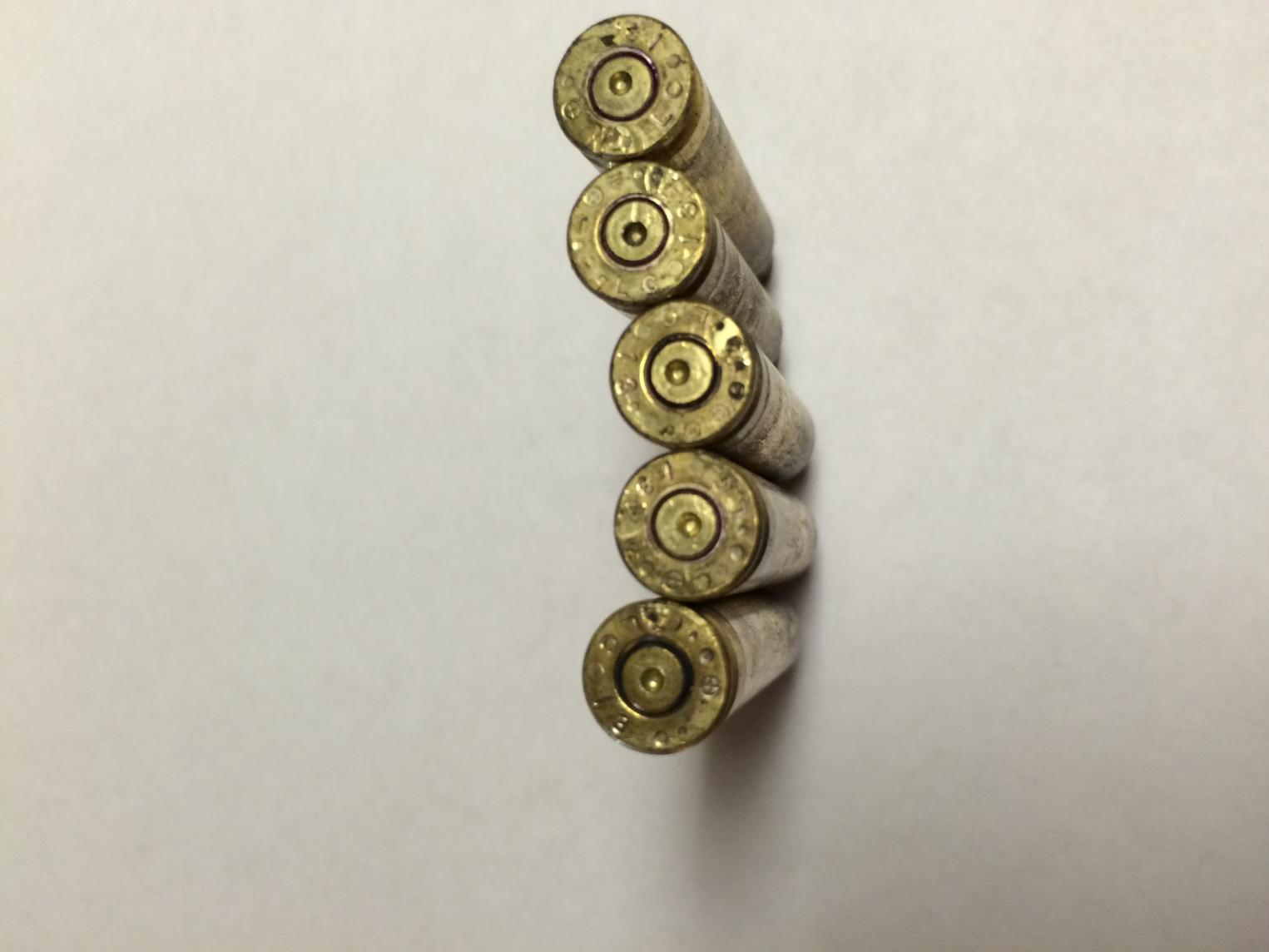

Shooting some Federal XM193 (120rds)this weekend and noticed that my fired cases were showing ejector swipes and had about 7 raised primers. Rifle is a 14.5 BCM, H2 buffer with standard spring. Has 4,000 rds through it with the last 2k being Wolf gold. My question is will a heavier buffer (H3, H6) help mitigate the pressure issue?
No,the ammo is just hot. The heavier buffer will only slow down the cycle rate of the weapon,and delay the unlock slightly. Xm193 is a full power load,it doesnt get much hotter than that. It almost looks like there was some pressure leaking around the primer pockets also.
Can you post some pics. of the sides of the cases something looks funny,anyone else see pitting on the sides of some of the cases??? Is there a ring around the fireing pin hole were gasses were escaping around the primer pockets?

Thanks for the reply Texasgunhand. The case on the left is what the fired cases with the raised primer look like. You can see where the gas was leaking around the primer. The crimp held the primer in. No pitting on the cases, just dirty. I was planning on changing the spring out anyway, if a heavier buffer would help lessen the wear, I was going to grab one also. I have 2.5k of the XM193.
Keep an eye on the bolt face around the firing pin hole, leaking primers can couse pitting. It would be best to post your question in the m4 general or technical on which buffer to buy,theres alot of guys running 14.5 barrels there. Bcm is a favorite around here,so you should get proper help.
I wouldn’t continue to shoot that stuff. The bright, shiny swipes are too much for my comfort level. A heavier buffer will only slow the bolt speed down a little, but won’t make firing that ammo any safer.

After reading your response and rereading texasgunhand’s previous reply about thecases looking dirty, I think (hope) that a dirty chamber is the issue. I gave it a solid scrubbing and will try it again this weekend.
Altho,keeping the chamber clean and carbon free is important in these and all rifles.
I think the ammo is just WAY to hot,xm193 is known to be hot,but if its trying to push the primers outa a crimp thats just way to much pressure. They should stay in place without the crimp. The military wantng faster and faster ammo they have reached the MAX for the .223 cartridge…
Ive seen guns with so much carbon in the chamber it was imprinting on the shoulders of the cases,but it wasnt pushing the primers out of the case and they were not even crimped. If markm says he would not shoot anymore of it, i dang sure wouldnt.

I do not see any crimped primers being pushed out of the primer pockets.
And I also do not see Federal intentionally selling any type M193 ammunition that exceeds max allowable pressure.
I shoot large quantities of XM193 and M193 ammo and have NEVER seen a over pressure issue with case head swipes and the brass flowing into the ejector.
And the ammo the military is shooting now is M885 and NOT M193 which is sold for commercial use and to law enforcement agencies.
Below are three five gallon buckets of once fired M193 brass and not one of the cases has case head swipes or brass flow into the ejector.

I will stay with my guess of carbon buildup in the chamber and throat and add the possibility of oil/grease in the chamber and in the bore.

The OP said he had 7 raised primers,xm193 is crimped you can see the crimp in the pics the OP posted.

There is carbon all over the OP cases, he had a dirty chamber that he said he cleaned and I’m waiting for his reply if cleaning his rifle fixed the problem.
