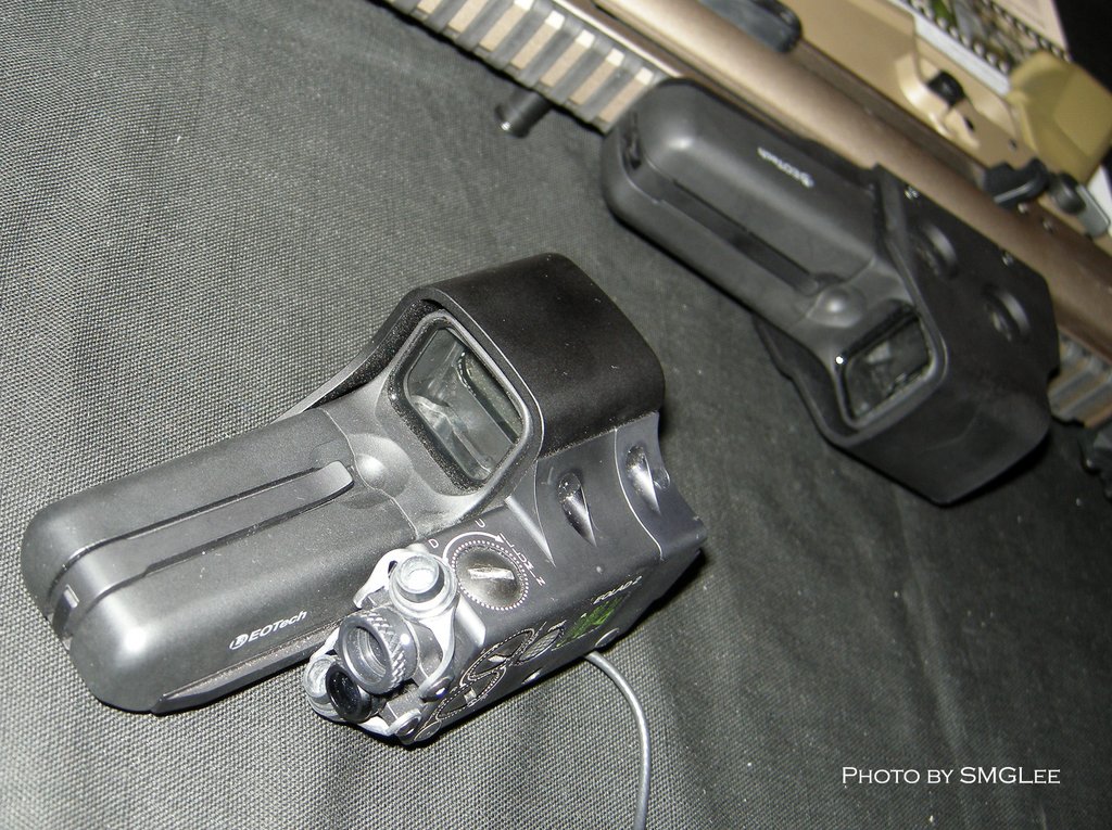

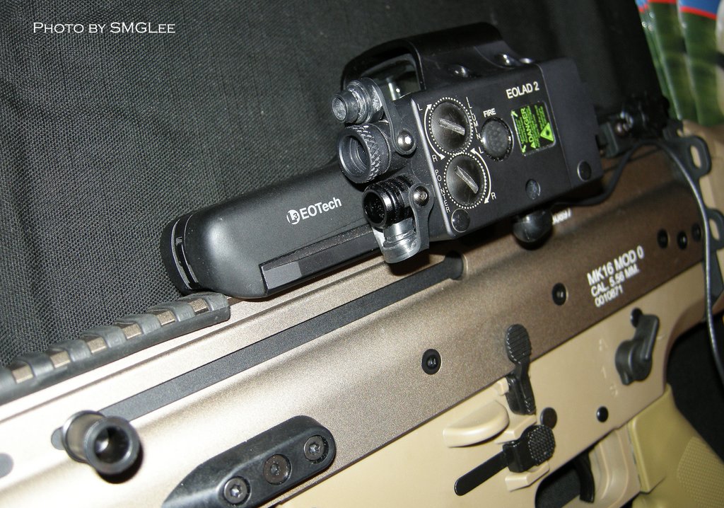

EOTech with Laser Device laser build into one unit. IR and visible laser share the same battery as the EOTech 552 in order to minimize the package and also to cut down on weight.
The visible Laser is a 5mW unit with range for visible in low out to 450m in low light and about 30m in day light
The IR laser is a -25mW to -100mW unit with reach out to 2000m in high out put and 600m in low setting.
Added a recoil lug to the cross bar screw for better security on the rail.

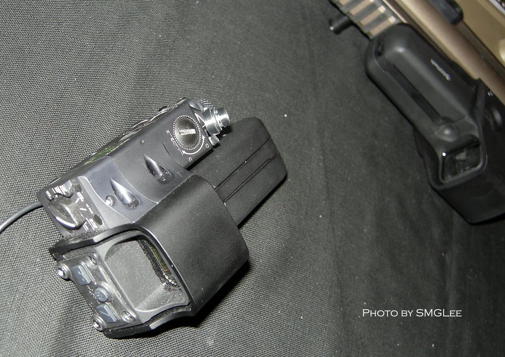

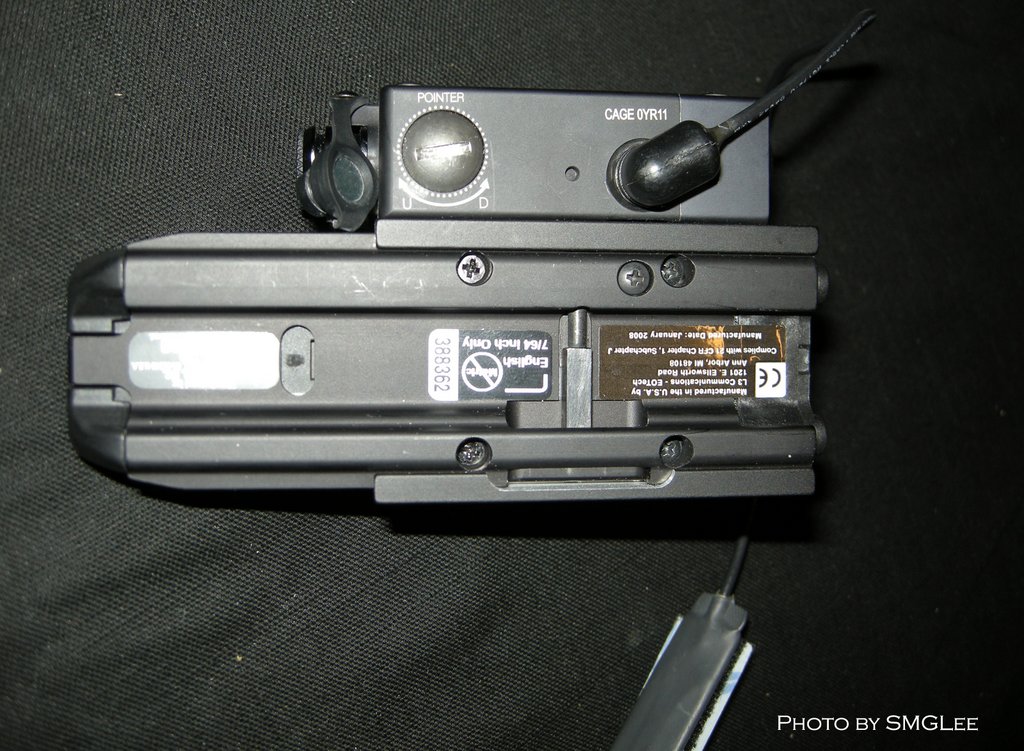

Control are in the rear with individual windage and elev adjustments. power source are contolled via the remote switch leading from the bottom of the unit ot the side button build into the unit. a double click on either the remote switch or the side button will set the beam on continous mode…

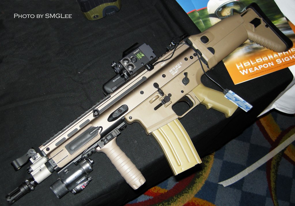

Two devices draining the same batteries, functioning from that same battery box? Two devices depending on that OEM mount? Egad…
If one of the components is deadlined, can the user/armorer replace it in the field, plug-and-play, or does it have to go home to the factory?
Very good point…but you can also look at it from this point of view… you only have one set of battery to change and worry about. run time is about 5 hours with both the sight and laser running on full blast, but most of the time the laser is on monentary so the battery life is running even longer…
This is definitely not the usual go out in the boonies and run the system for days…or at least you might need a healthy supply of batteries. this is more for the close in urban work. especially for thise type of short length gun without too much rail spaces.
Both the EOTech and the Laser device are proven product but if one failed, you can still use the other…and if one unit fial, it will have to be replaced at the manufacture level…it is not likely if you have an separate EOTech or laser device that you could fix it in the field. the turn around time is usually two weeks.
