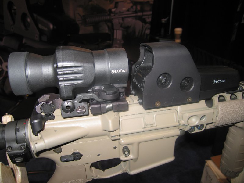

from my experience the buis will NOT fit under the 3x from eotech. unless you are running a Vltor full top rail. but the the front and rear sight dont clear the eotech. hope this helps

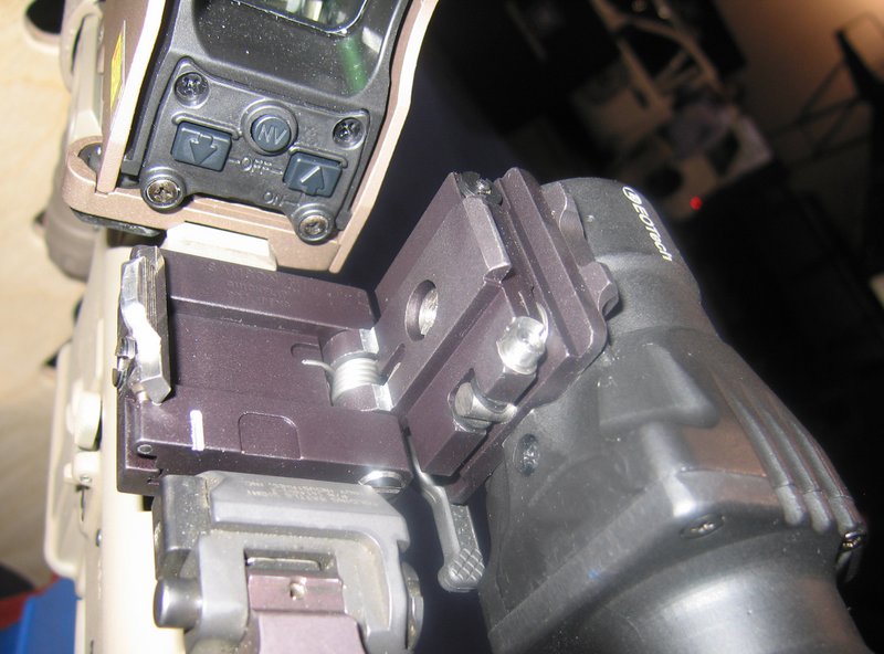

The EO tech 3x will flip over troy rear buis and I would assume others however the 3x must be flipped to the side or removed to engage the rear buis. Due to the 3x eye relief you will most likely want to mount it as far rear ward as possible, basically right in front of the rear buis. Another nice feature is that the flip mount is ambitextrous and can be mounted to flip right or left however it would be nice if the adjstment screws were a little more heavy duty. I have been running this setup for several months and the 3x will allow taregt identification and more precise target engagement at further distances if you have a need for that.

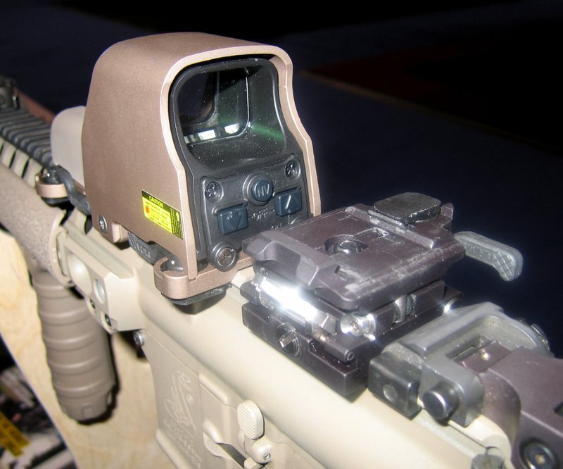

Here are some LT configurations…
I use the configuration, not recommended, shown in the very bottom w/o a problem. EoTech with flip behind it.
Except I have the flip & eotech forward enough to use a buis.

Does anyone make a flip to side mount for the eotech 3x? I have the fixed mount on mine but am considering the other.
DocGKR’s set-up uses a LT-649 I believe…

Eotech makes one here is a photo of one in use:

You can not use a LaRue Aimpoint magnifier mount on an EOTech 4x magnifier. the 4x magnifier has a picatinny style edge on the bottom where the ARMS mount on the EOTech/Samson mount lock into. that is unless Mark design a mount with the throw lever that can attach and detach the magnifier.
Note the mounting solution that EOTech chose to secure the 4x.
