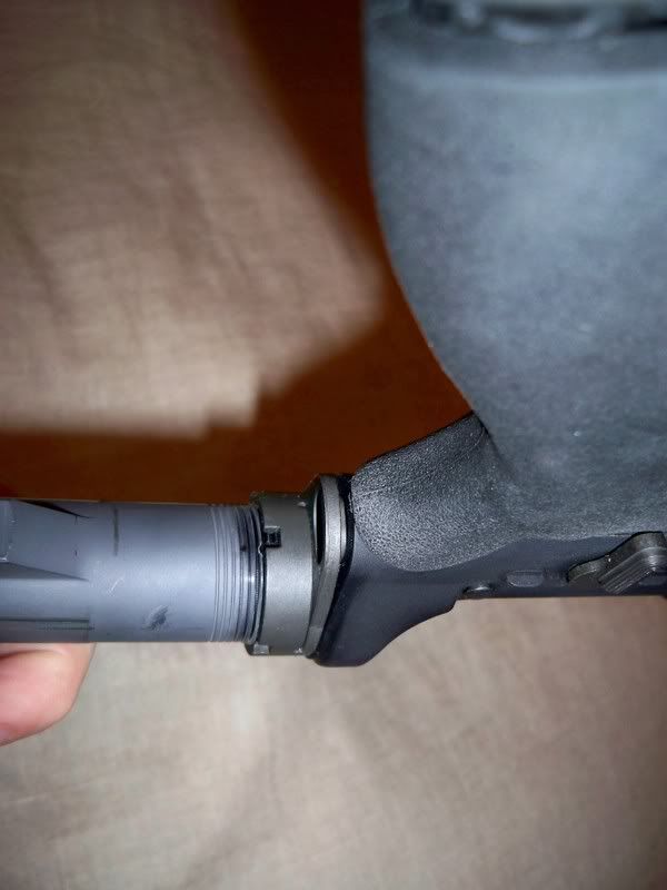

Hey guys, finally got my camera for Christmas so I have the ability to post pictures of my issue. I recently had my FFL order me an LMT lower that I plan to make into an SBR. Ironically my FFL called me ON ELECTION DAY and told me my lower had come in so after casting my vote I went and picked it up. Fit and finish are good with the exception of one thing, the endplate. When I received the lower the lower end of the end plate has about a 2 mm gap between it and the receiver that I haven’t seen on an AR before. The reason why I am getting yalls expert opinion is I dont care how my rifle looks, I just need it to function . . . every time. So I need to know whether the end plate on my rifle is indicative of a problem that will affect functionality requiring me to contact LMT and get it fixed. If its just cosmetic I dont care and Ill leave it the way it is. Thanks for looking!
Pictures below are how the rifle was received.
It’s not a big deal to swap the end plate out for a new one, but that’s not right and it should not have left LMT like that. It’s hard to tell if that end plate came bent, or if it didn’t fit right in the recess and bent during assembly. I’m sure LMT would fix it if you didn’t want to mess with it yourself.
Thanks Eric, I was just concerned if I replaced it myself I am not up to speed on how to correctly stake the castle nut so if it wasn’t important I didn’t want to break the castle nut loose.
It needs to be fixed. You can already see the detent spring showing and with the end plate not correctly seated, it’s more likely to slip out of place and launch the spring (and they are always a bugger to find!).
Email the pics to LMT. They will take care of you.
wow… how the hell did that get out of the shop?
i think your best bet is just having them send you a new endplate… otherwise you’ll be without a lower for weeks. steaking the castle nut is really easy- just give it two, three hard taps per socket with a nail set. you get get a nail set set at walmart for probably 5 bucks.

Ok sent them an email today I will let you know what they say. I plan on building my AR tool kit as these types of things occur, so next question what is yalls prefered Castle nut wrench? Im sure like most tools, grant and rob and everyone have figured out which one works best for them and I would like to hear because I like to attempt to buy the best the first time. (so far I am 0 for 1) :slight_smile: Thanks!
For a wrench, I picked up the Rock River model from Brownells. Inexpensive and for my purposes (switching out a few stocks) it will do all I ever need it to do. Would be pretty easy to add a cheater if you felt you needed a bit more leverage.

So LMT denied my request for a replacement endplate, detent pin, detent pin spring and castle nut (didnt see any need for a new buffer tube. Their reply was one line " Please call for a return authorization #." Since I really dont care for my lower to be out of commision for that long and pay shipping back and forth I will just order the endplate and wrench and fix it myself. Thanks guys!

It’s probably company policy to do any repairs in-house. The reasoning could be warranty or insurance related (or a combination of both). Most gun manufacturers will void a warranty if anyone other than them perform work on a gun beyond routine maintenance. They simply have no way of verifying that the work will be done correctly, even on very simple repairs.
Fortunately, the affected parts are cheap and it’s an easy fix. You could probably straighten the bent endplate with a few taps with a hammer and keep it around as a spare. Since you are paying to ship new parts, I’d pick up some extra springs and detents as well. There are few things more depressing than launching the only spring you have on hand down an air conditioning vent while trying to put a gun together.
