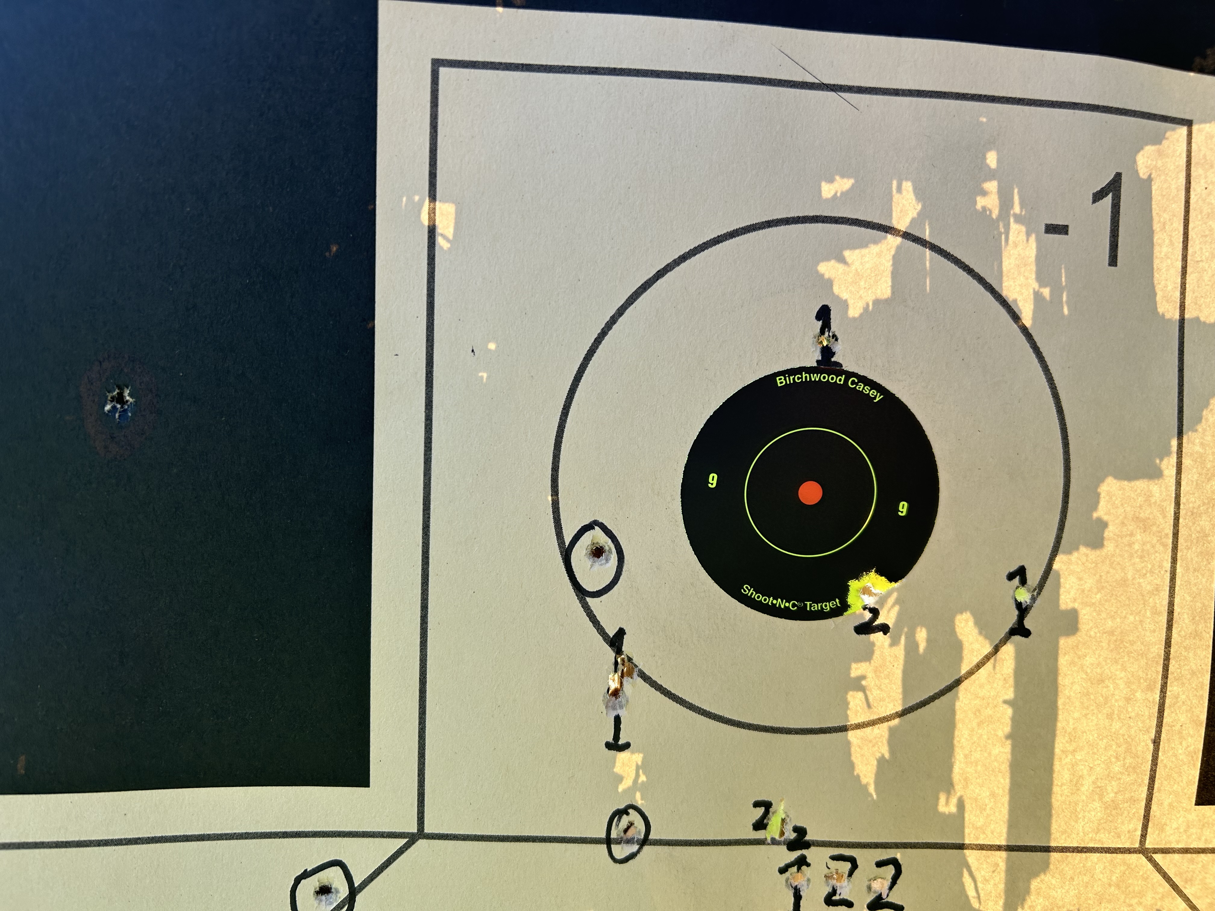

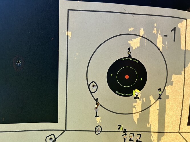

50 meters, MP15-22, Eotech, 2” stick-on target, CCI Clean.
The setup:
Results:
The 1s represent strong eye only, the 2s are for both eyes open, and the Os are for occluded. 5 shots ea.
