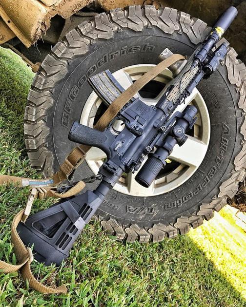

You might look at the Leupold MK6 1-6 as it really is one of the lightest variable powers in it’s class at 17ozs. Try to get as lightweight as possible on your mount and maybe keep it around 24ozs total. Just shy of a 1/2lb increase over your ACOG but you gain a true 1x that’s very nice with a decently bright illumination setting, and when cranked up to 6x (depending on reticle choice) you’ve got a lot of tools in the tool box for making hits further out.
Like this:
(not mine)
