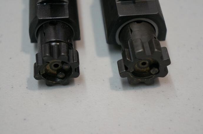

I know it’s a bit of an old thread, but I thought I’d share some comparison pics of the new and old DPMS in case anyone was interested.
I’m sure you can guess which is which.
Thanks for the pics!

However, my main question/concern is the bolt, let me explain.
Given that the .308/7.62x51 is wider at the base that the 5.56, and that this bolt is the same diameter as the 5.56, is there enough “meat” on the bolt for long term durability?
From what I understand, 7.62x39 AR suffered bolt issues for this very reason. I do notice that the LMT MWS/DPMS GenI .308s/KAC/Sig 716/etc. bolts have more material around the lugs than the DPMS GII.
See this picture posted above for reference:
http://s273.photobucket.com/user/craigklee/media/DSC04566_zpsad1a37ff.jpg.html
I am interested to hear input on this as far as potential long term durability, etc.
Thanks.
