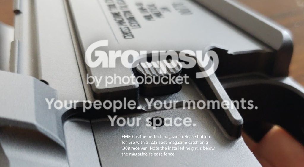

We seem to be the only manufacturer concerned about it, it was known to us in 2014.
I wrote about this in 2015, a warning is in our EMR-C (blind hole, taller profile) to not use it for duty or defense because of its installed height over the fence, the warning language is still there, and we moved EMR-C to 308 AR section to further discourage its use on AR15s.
http://www.forwardcontrolsdesign.com/EMR-or-EMR-C_ep_55-1.html
I recently updated our thoughts on this matter in a new article on our site http://www.forwardcontrolsdesign.com/Overcorrection_ep_69-1.html
During our EMR development, we took a careful look in everything, especially the parts our new design would be working with. The “ramp” part of the mag catch plate is but 0.05 in height, which means anything over 0.06 protruding over the mag release fence will effectively render the fence useless. EMR doesn’t protrude over the fence when installed properly (9 full turns of the mag catch)
EMR-C that has a taller profile is great for 308 ARs when an AR15 spec mag catch is in use, its top doesn’t protrude over a 308 AR’s mag release fence, if it has one.
Extended mag release buttons that have a rearward extension have their uses, namely, for users with small hands and short fingers, but at the cost of having the button protrude a great deal over the fence, off-axis travel of the mag release, and becoming more snag prone. Single feature for a limited number of users with multiple shortcomings isn’t a solution for most.
As it is, many users have to curl their index fingers to reach the magazine button, placing the pad further back isn’t helpful.
The 2019 production of our EMR-A (ambi mag catch) now has the LP (low profile) shaft as standard, it is precisely one full revolution of the mag catch shorter. When installed with a TDP spec or our EMR, the top surface of the mag release button sits below the fence further. We also increased the height of the “ramp” on the mag catch plate to make it more difficult to accidentally drop a mag, the user has to make a conscious effort to do it. It’s like the antithesis of the taller or extended mag buttons, as it aims to do the opposite of what these things do.
