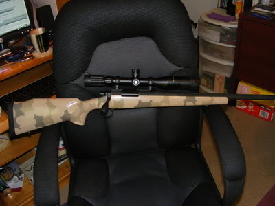

I’ll second the recommendation of the SWFA 3-9x42mm. PA is not needed, and the turrets don’t seem too large. Here’s mine on a Rem 700 .223 with sun-shade and BC caps attached.
