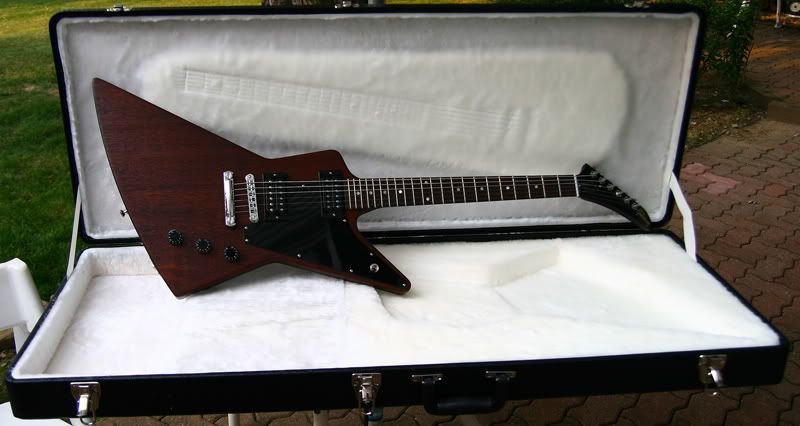

I intend to use a Gibson type stencil to disguise a case at some point. Below is my current Gibson case, I suspect I can fit two complete rifles with a few mags no issue. I will probably start with an SKB type case that is lockable.
