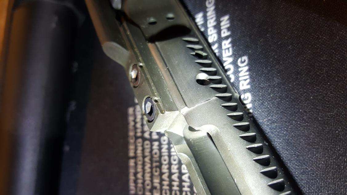

Wanted to follow up to this. Upon disassembly, or starting to disassemble anyway, I noticed what appeared to be a crack along the side of the PSA BCG. It wasn’t significant, but it ran the vertical length of the carrier. So I replaced it with a Toolcraft BCG and it seems to be working well. I should have more range time in the next few weeks and will report back. Pics of the BCG attached.
