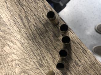

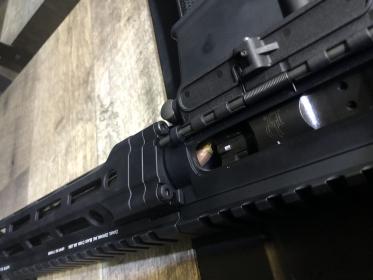

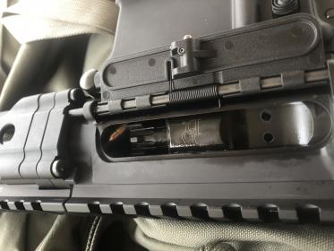

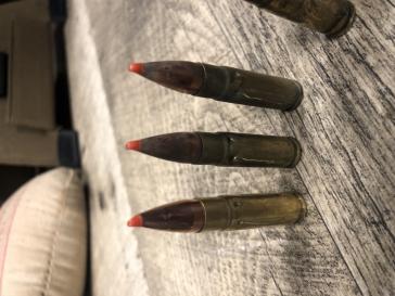

I just purchased a DDM4V7P in 300 blk. My first 120 rounds had about 10 FTF with both sub and sonics while shooting suppressed. The casings eject fine but the next bullet gets wedged nose up by the BCG.
The gun was properly lubed :wink: and I was using 300 blk Pmags.
My guess is I’m over gassed but wanted to see if anyone could point me in the right direction. I currently have a law tactical folder, sb3a brace and H1 buffer. SBR tax stamp on the way (maybe i should have waited). I’ve researched the A5 system, JP SCS, and H2/3 buffers but the information is overwhelming. Any ideas so I get it right the first time?625CB8D4-08B3-43AA-9CDF-352D60C3BB02.jpgC0EC1690-B01B-47F8-8EE4-CA2CB866033F.jpgAFD2FBDF-F2EB-48F5-B524-4582CE3A5841.jpg40E126C7-37A3-4D43-82B6-93A18FD3732F.jpg
Try one round at a time to check gas and full function(travel) of BCG, you should get lock back-insure it’s the mag follower pushing the bolt catch up engaging the bolt itself. You are either getting either to much or not enough gas. Not enough if not locking, if you are then you have to much and will need bandaids. Something to look at also is if not locking, put a standard buffer in as the LAW connecter adds weight. For reference with a BCM .300 pistol I had no issues with a LAW and an H2 but I have no knowledge of the DD’s. I used either Lancers or 20 round MP’s. If that mag is full, it may not be pushing the next round up fast enough and if over gassed, will do this also.

This type of malfunction is not directly caused by over gassing. It’s caused by weak extractor and/or ejector springs. The dents on the case mouths are from catching on something because they are not being properly rotated out during ejection. The empty impedes the BCG as it’s is trying to feed the next round in the chamber. This causes the bolt to override the base of the new round. Over gassing places extra stresses on the springs, exposing those springs which are only marginally functioning. But if the springs are good, the AR would need to be extremely over gassed to start malfunctioning like this.
